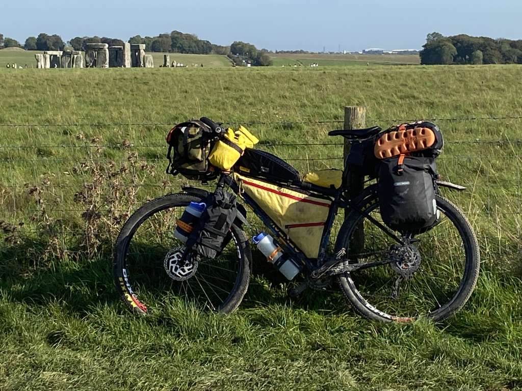

I used a pair of gravel panniers on the rear to bikepack across Europe in September- no problems, worked well, completely waterproof, didn’t hit my size 12 feet. Good way of expanding usual slim line bikepacking set up for more food etc. Much easier to get on and off than strapped on bikepacking bags. I used them on an Ortlieb quick rack hung from the top horizontal rod because I couldn’t bring myself to spend £150 on changing my Tailfin rack support so I could put panniers on it. The gravel packs and an Alpkit Big Papa made a great rear storage solution.
IMG_6293

I have to say I look at that set-up above with lots of little, hard-to-access bags attached to every conceivable part of the frameset, and think that kind of touring is probably better served by four conventional panniers that equate to the same volume. Or even, God help me, a trailer (on second thoughts, nah).
The point of 'bikepacking' as distinct to touring is to carry less stuff, enabling you to ride terrain you probably wouldn't with a bigger load. Removing bolted rack type fixings that break goes along with that approach.

I was riding a mix of on and off road routes, camping and cooking all the way - I needed to carry food for a couple of days occasionally but still wanted to be able to push my bike easily on the hike a bike sections. This is the perfect arrangement for this kind of travelling. Anyone who says you can make do with less hasn't really done it for any length of time, or is staying in hotels or something.
I do carry a lot of camera equipment though (it's my job), so that doesn't help.
