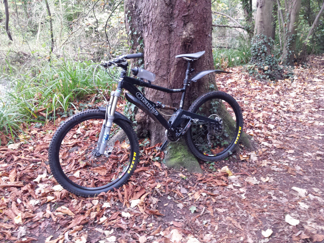

orange five bottle cage
Photo looks like bottle is fouling shock. It isn't!
