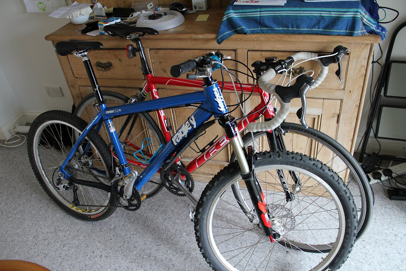

Posted : 05/08/2010 8:50 am
Thank you all for the advice. I ended up going for a Ragley mmmBop with Revelations with the Hope Minis, XT drivetrain and Merlin built wheels nicked off my old bike. Took me about a month longer than planned to built (my now 9 week old son's arrival redirected my attentions).
Really enjoying riding it - slacka angles and long travel give me confidence on the downhills i didn't think I had.
Cheers, Lockers
