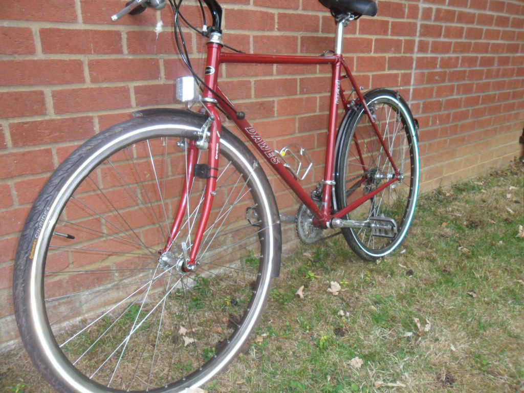

Posts: 897
I'm still using a 1995 Dawes 'On Road/Off Road' Hybrid that I purchased in 1995.
Running a 700 x 32 Continental tyre for all occasions.
Frame is Reynolds 501.
Using mainly the original components as well - BB, hub bearings, rear brake cable, steering head bearings, front mech, rear mech (jockey wheels replaced) paintwork. Keep it clean and when washed, dry off with the airline. Clean and grease once per year.
Commute 4 miles each way most days. 80% tarmac.
[url= https://i.postimg.cc/HsqNR3VF/SAM-6627.jp g" target="_blank">https://i.postimg.cc/HsqNR3VF/SAM-6627.jp g"/> [/img][/url]
