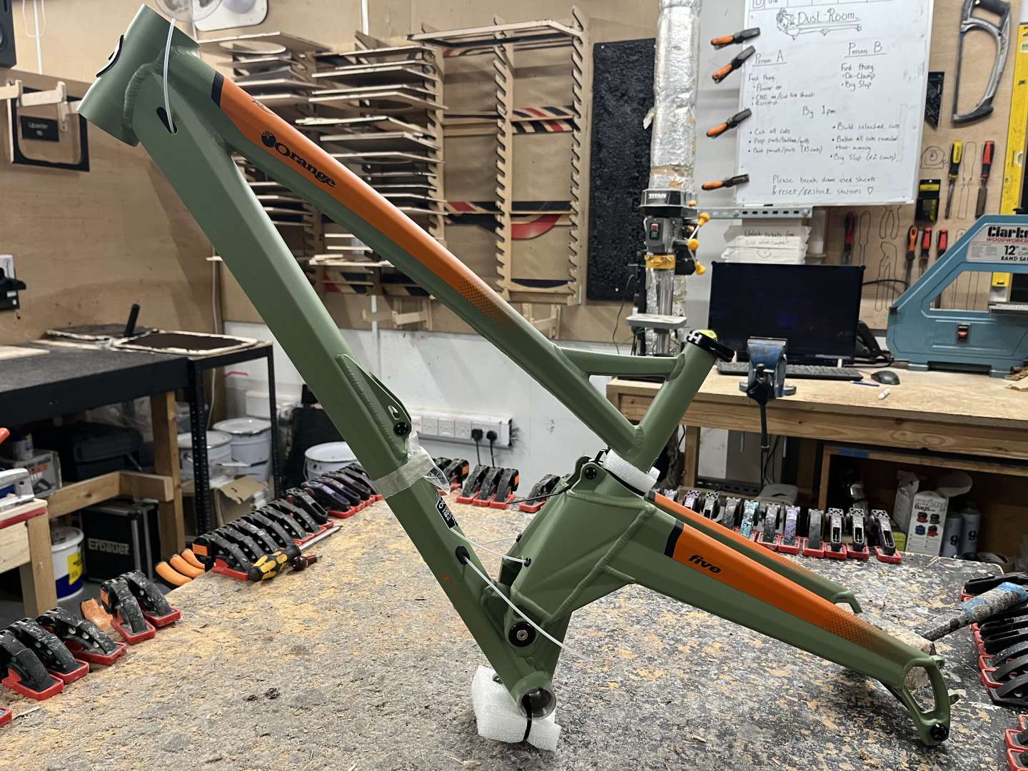

It’s a NOS Mk 12 that they found somewhere at the back of the factory.
I’ve been looking at cheap secondhand frames for a while because I have a pile of unused old parts and wanted to get a spare bike or two sorted for staff commuting. And I was going to build my old Bird Zero AM back up for my eldest to use as she’s done that girl thing of getting much taller very quickly - which also means that a bike that fits her will also fit my wife.
Anyway, I saw this very discounted frame which fits the unused spare shock I have for my Levo and almost all the parts off the Zero, so the Zero frame (which I found great when I was in the zone and downright cantankerous when I wasn’t riding well) is being used for the staff bike and I’ve now got a 27.5 family full-sus to build up.

I must weigh it before I add more parts - it feels bloody light!

I did find some luggage scales though - frame as shown in the photo, 2.67kg (5.89lbs).
