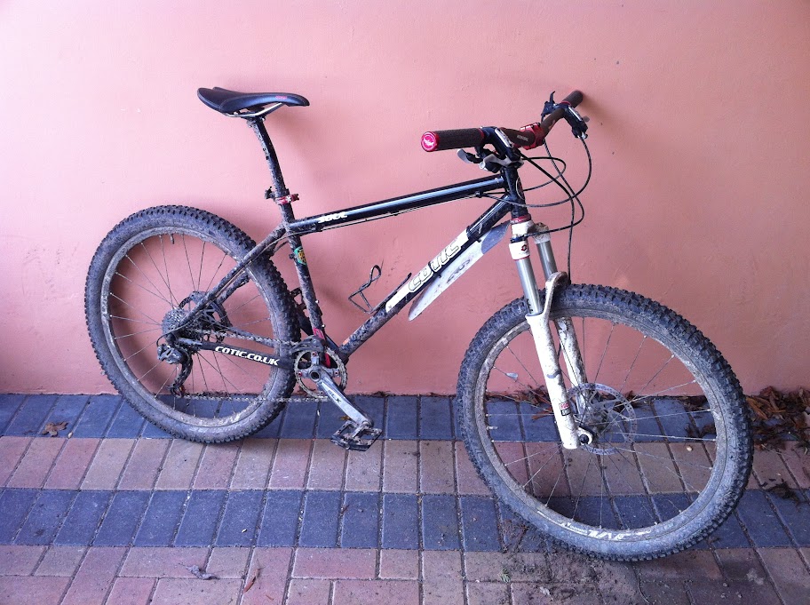

Used to run Rockshox Recon U-Turn coils on my Soul (85-130mm) they were great, but a bit heavy and to be honest, I found I mostly left them at around 120...
I weigh about 12st and last year upgraded to some SID RLT Ti 120mm with poplock and haven't looked back. The Soul frame is so nicely balanced for ups and downs at 120mm and the lockout plus the SID's lightness more than make up for the lack of travel adjustment:
You can pick up a new pair of SIDs, Rebas or Revs for around £400 if you look around, I bought mine from Merlin Cycles...
