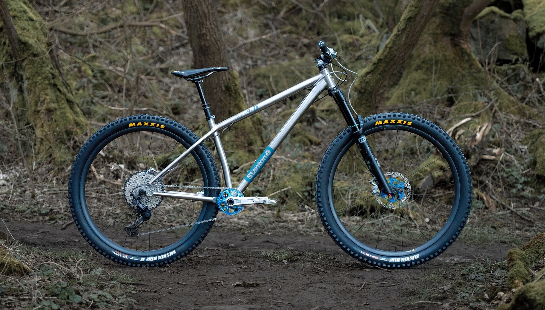

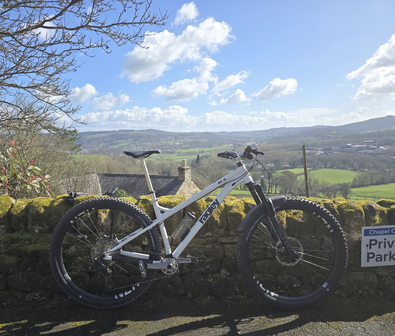

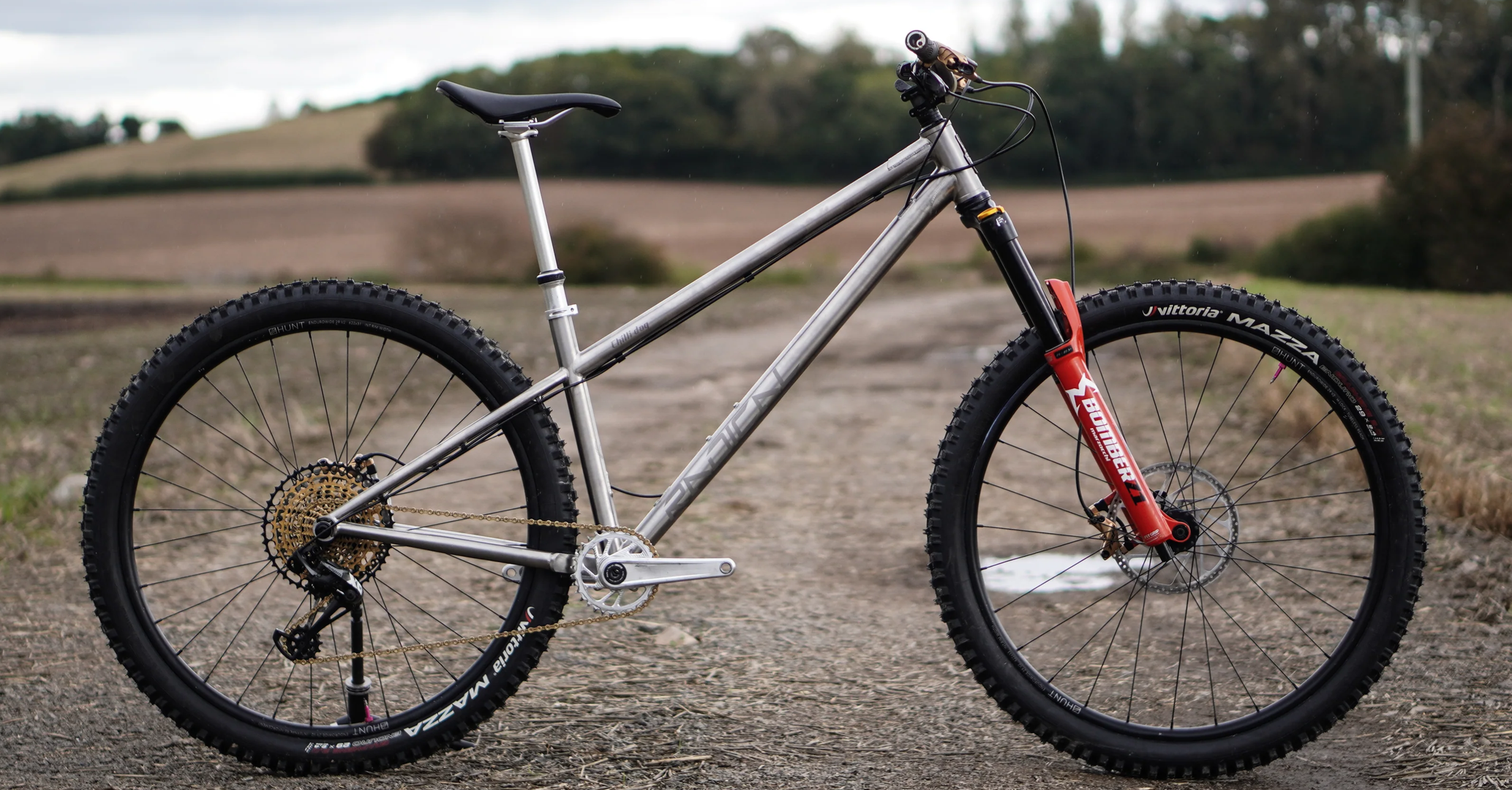

I've considered a Ti HT build before and considered both these bikes. Similar purpose (aggro HT) but different geo - can make both work for me though. The Stanton Switch9er pictured is a 16.5" and I'd be going 18" so the proportions would be bigger (and I wouldn't go for the blue). I think the Chilli Dog is a large, so would be the size I'd go for. Switch9er has a few hundred off list atm, so sits just £100 more than the Radical.
Stanton politics aside (or not), which floats your boat - nothing more than Saturday morning musings and I have an itch to scratch?
The Radical has been on my radar for a while - I know some don't like the angles, but it looks huge fun. Stanton (was also on my radar before I built the FS) is arguably more nicely finished with details. Radical has external routing - dropper aside

I like the look of the bottom one - is that the radical? The angles look good to me unless you’re doing loads of long distance! I love my relatively hardcore hardtail and it does everything - admittedly it’s not as hardcore as that!

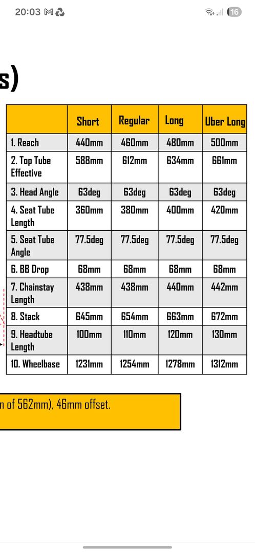

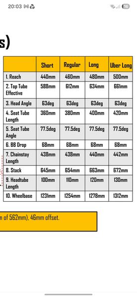

The seat angle is a bit of a concern. When I built my Ragley I found the (relatively) steep seat angle a revelation, especially with the length of the bike.
The Radical has the same reach and stack (and is surprisingly only 0.5° slacker up front). The seat angle is 2.5° steeper though and therefore the ETT is -24mm. Coupled with that, having quite a bit of seat post showing, the slacker angle of the Ragley puts the saddle even further back. The Ragley feels like a good riding position, with similar numbers elsewhere, riding the Radical might feel akin to sitting on the nose of the Ragley saddle 🤔
To get a similar ETT on the Radical I'd have to go for the Uber Long that has a 500mm reach (vs 480) as well as a massive wheelbase and is recommended for 6'1" upwards. I'm 5'11" with long legs

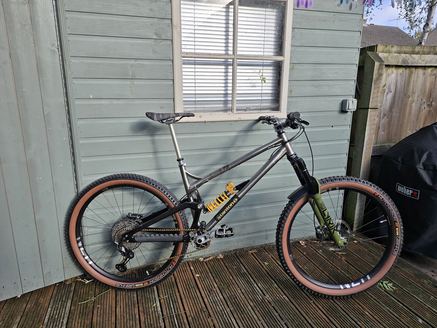

My Stanton is 76deg SA, so sits between the Ragley and Radical - reach is 10mm shorter than both and 10mm less ETT than the Radical and 23mm shorter ETT than the Ragley. I have a 42mm stem on the Stanton though. It rides really well, but a few mm in the wrong places makes a big difference for me.
