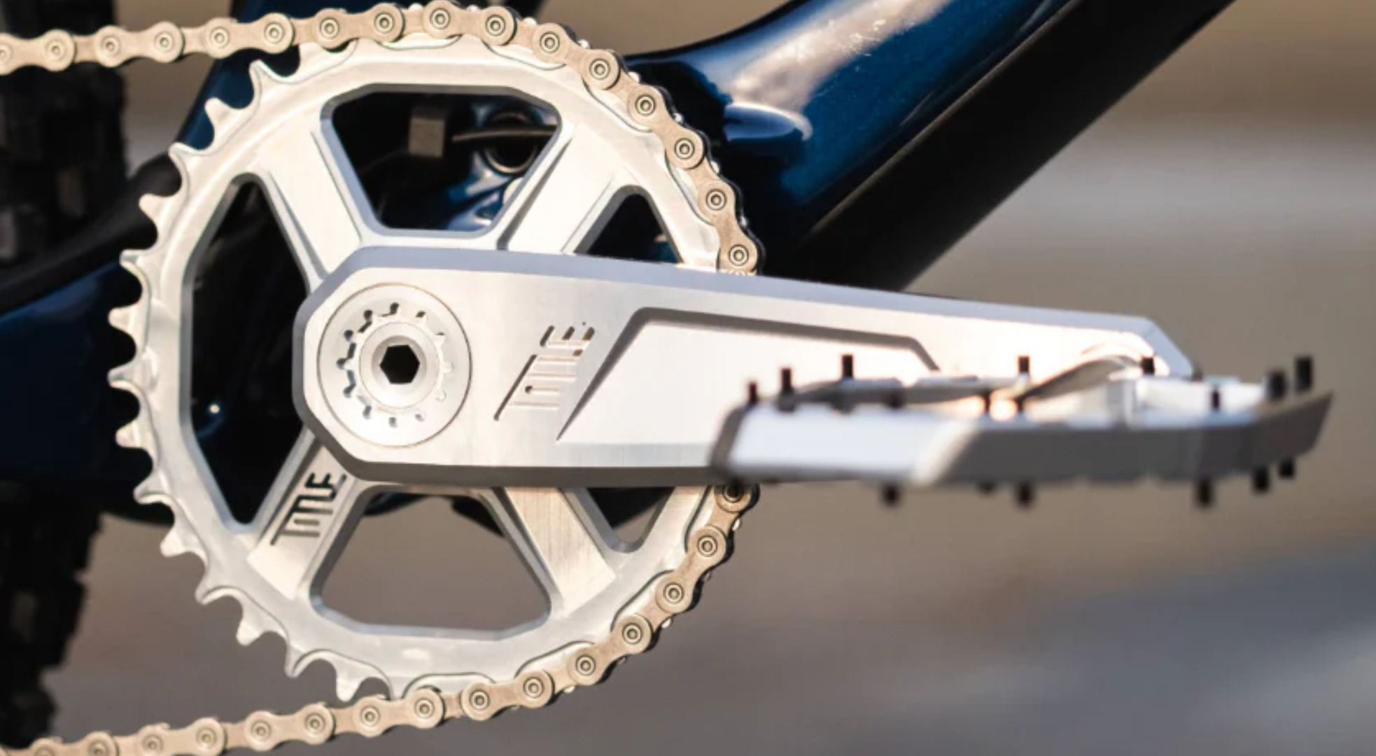

Short story - when I built up my new bike at Christmas I wanted some short Unite cranks for the build but it seemed like they were "doing a Jaguar" by stopping making their old ones before starting to build (or even develop?) their new versions. Fine - I shoved some 170mm cheap XTs on as a temporary fit.
Here we are 8 months later and Unite still seemingly haven't released their new cranks so I think its time to start looking at taking my business elsewhere (shame as I have a set of their previous cranks on one of my other bikes and love them). Would prefer to stick with UK made where possible and whilst I quite like the look of the Hope cranks, I think their pricing is fkn mental vs Unite (and I prefer the understated look of the Unites). So I had a quick look at Middleburns. Right colour/length/look but I've not seen a set of Middleburn cranks on a bike for probably decades! Given they'll be going on a bike that sees some abuse (enduro type stuff, Alps trips etc), will they hold up to it?

I always knew Middleburn as cranks for square taper and ISIS bottom brackets; never saw them offering HTII cranks, which may have affected their uptake or availability. Probably still great cranks, but it's ruled them out for me!
Posted : 20/07/2026 2:18 pm
Posts: 9276
I've got loads of Middleburns.
RS8 X-types (HT2) on the XC race bike and the do-it-all hardail. RS7 square tapers on the full suss trail bike and the enduro bike. RS6 (I think, maybe RS5) road cranks on the gravel bike, also square tapers.
The two square tapers on the full sussers get a bit of attention, a 2014 Orange Alpine 5 and a 2018 Cotic Rocket. Can't fault either. So yes, they should be fine. I've got a pedal stuck in the road ones but that's probably due to zero maintenance.
I've got Hopes on the fattie as Middleburns don't do a fat bike length axle. Hope don't do 24mm, despite doing a 24mm BB.
Posted : 20/07/2026 2:21 pm

middleburn cranks are still great. only letdown is the really expensive direct mount chainrings, really expensive spiders if you want to use aftermarket chainrings, and the lack of aftermarket direct mount.
Posted : 20/07/2026 3:57 pm

Yeh the chainring thing is a pain. Moreso that weirdly their Uno rings don't work with 12 speed Shimano chains (which I run).
Ah well, back to the drawing board - might just wait a bit longer in the hope (no pun intended) that the Unites arrive with their SRAM fitments etc.
