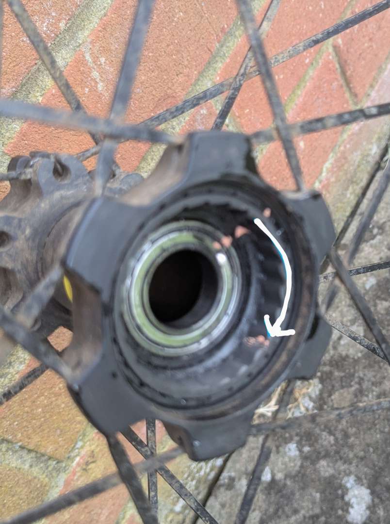

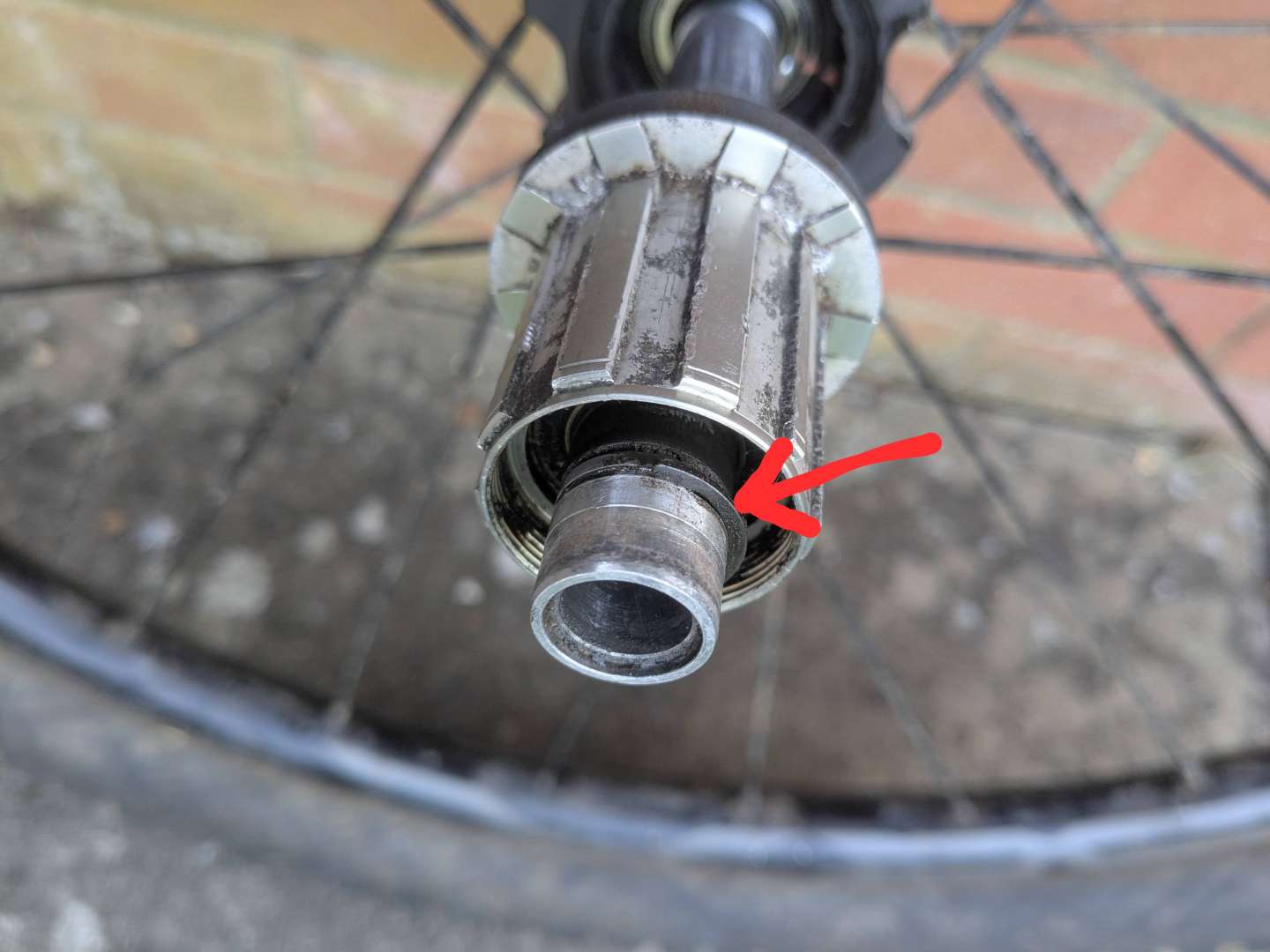

So I have 2 E-XA elite wheelsets, on one the freehub just pulls off with a bit of force, the freehub internals were identical in both
this one had c-clip holding the freehub on, you can see it here with the axle slid out slightly (id removed the circlip on the non-drive side to let it do this)
you can see how the c-clip sits here when its flush -and there was a circlip that sits around the c-clip but under the brassy-coloured lip of the freehub- that Ive removed
My problem is that the ratchet ring inside the hubshell is rotating, you can see where its moved, I marked it with pink paint reinserted the freehub and turned the freehub by hand
even though it rotates I cant actually get it out, but if possible I was wondering if I could loctite? it in place, what would be an unbreakable adhesive I could use?

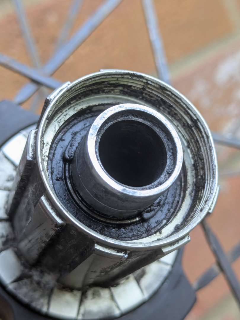

I finally got round to taking apart the rear hub. Similar to the video above - but not. It's some variation on the ID360 freehub.
No spacers or anything on the axle. And I still can't get the damned freehub off the axle! No circlips either side. Tried whacking it out: no good. The slotted washer on the outboard side of the freehub is just to hold in the bearings, as per video I linked higher up.
I'm still going with the 'races corroded onto axle' theory. Oh well, reassembled for the time being. Time to contact Mavic.

For the sake of closure - the following video is my rear hub, but under a different name:
So the freehub should just pull off, but seems welded onto the bearing races (you can see them turning with the axle when you rotate it). Mavic never got back to me. It's beyond the scope of my little screw-on vice to deal with the hammering required so I've reluctantly conceded defeat and given it to the local bike shop. The sealing on the hub isn't great and, with hindsight, I should have taken it apart when I bought it and ensured everything was properly greased up. Lesson learned on that one.
