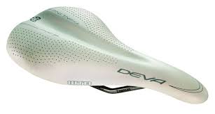

Abigale and Katie use WTB ones again with no problems
[img] https://encrypted-tbn3.gstatic.com/images?q=tbn:ANd9GcRa761VqR_RZMFNGlxZI1wMRwpoQhPjfKTZnICrxdnbPlTgqgJ5 [/img]
Where are you based, might be able to sort one out to try
