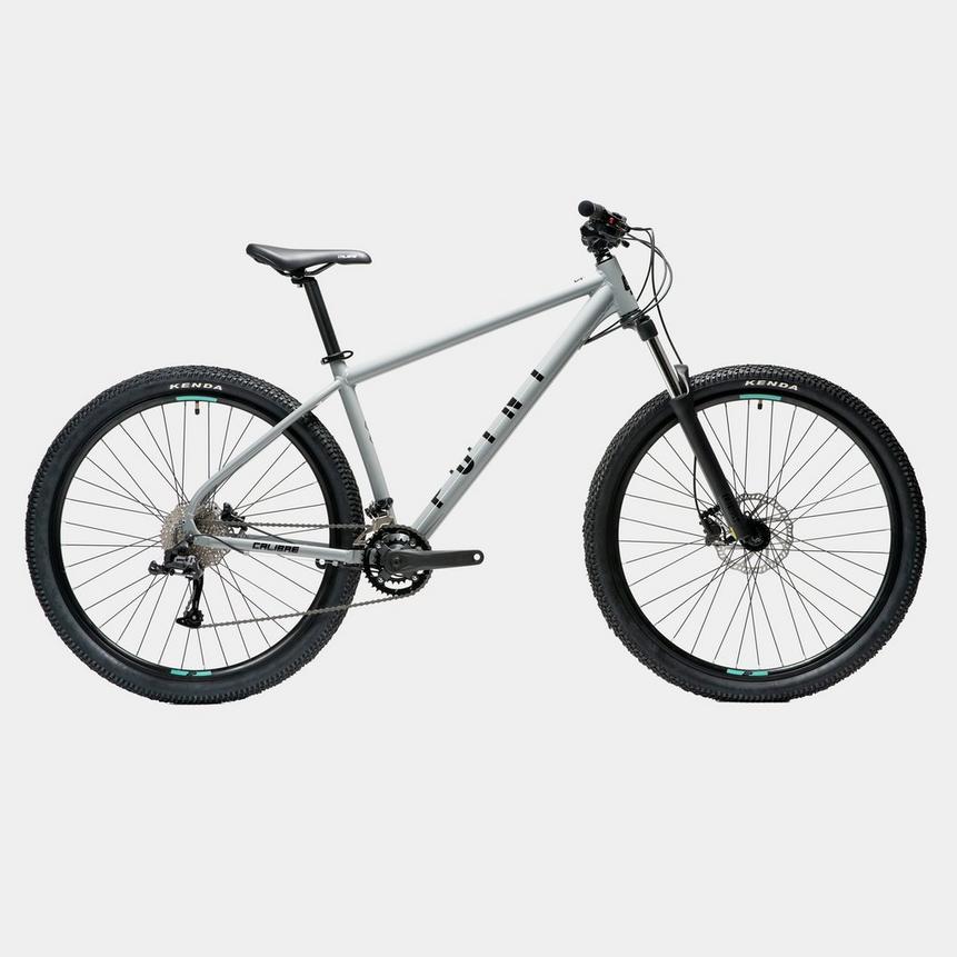

I recently traded our big A-Class motorhome for a Camper Van. In the Motorhome the bikes lived in the garage out of sight. In the Camper there is just about enough space to get a bike, with wheels and bars off, under the bed … but not my Speciaized Levo so that ends up on on the tow-bar rack, which is not an ideal situation.
Sometimes I just need a bike with me for pub/shopping and bimbling duties, so I figured I’d grab a cheap s/h hardtail and Bafang it.
I already had a 36v 378wh battery as I have the TrailWatts extender kit on my Levo. I can’t ride both bikes at the same time so an effective use of the battery I figured…
I spent a a month or so watching Gumtree, eBay etc with a budget of about £300 but I couldn’t see anything that didn’t either look stolen or knackered.
Then I happened across this, new for £350 …
https://www.gooutdoors.co.uk/16210931/calibre-point-29-hardtail-mountain-bike-16210931
Reasonable enough for knockabout bike and it’s actually quite nice to ride.
I pondered over Bafang and the tsdz2 Tongsheng motor kits. Ended up going for the Tong as it was cheaper.
Ordered the motor kit from Pswpower for £235 and a pair of Big Apples tyres from Ebay for £32.
I needed more tools, so spent another £50 on a Crank puller, C Spanner and Cup Wrench BB Spanner .. I also got use my bearing press, for only the second time ever, to hold the cup wrench in place while I hit it with a lump of wood...
The build was very straight forward, front derailleur and shifter removed, then pedals off, cranks off, BB out, motor in, wheel sensor, magnet, display panel and power selector switch fitted.
Managed to thread the cable to handlebar mounted display through the internal cabling route. Battery sits in the water bottle.
Turned it on, then configured it; set wheel size, power mode and removed the 25 kmph restriction cut out. Motor is 250 Watt so tis legal.
Weighs in at just under 20kg. Also looks pretty OK - not obviously an Ebike at first glance.
Noticeably lighter than my Levo. Doesn’t feel as powerful but is a much more natural ride.
All in all for £600 plus a battery its gonna be a useful machine I reckon.
Quite pleased with it!
New bike day!
Strip it down
Motor in
It ain't too heavy!
Big Appled street fighter mode!

Nice job.
Not without the restriction 🙂
Posted : 04/04/2022 3:29 pm
Posts: 17263
Tis a fine machine and will serve you well.

Yes - it's torque sensing and the ride feels very natural, no sudden snatching. I actually bought the slightly cheaper kit without the brake sensors as if you stop pedalling its stops the power assist.
You just need a battery and suitable tools to remove the BB.

Very nice! And that Calibre is almost offensively cheap for what it is.
It was a bit of a punt but has worked out better than I though it would.
Obviously it’s not legal with the cut off taken out but other than that it seems tidy.
I turned the cut-off because my Levo is noticeably draggy once you get beyond 25kmph/15mph, the Tongsheng is nowhere near as bad. I reckon even with the cutoff on it would be very rideable.
