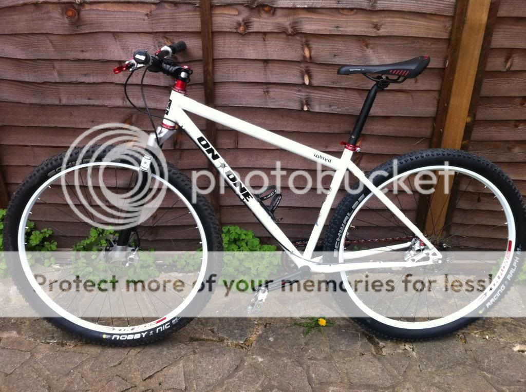

Photo of my Inbred in it's life-before-Rebas incarnation .....
[url= http://farm9.staticflickr.com/8092/8407392999_c51d6e4a21.jp g" target="_blank">http://farm9.staticflickr.com/8092/8407392999_c51d6e4a21.jp g"/> [/img][/url]
[url= [/url] by [url= http://www.flickr.com/people/simon_r/ ]Simon_R[/url], on Flickr
