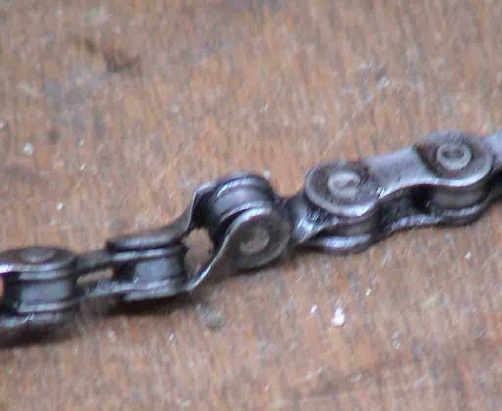

Minor crash yesterday, down a gentle slope with one hand on the bars. Hit the deck hard but landed on that soft loam you get under beech trees made from hundreds of years of beech masts being laid down. No rocks or roots in sight. When I rode off my drivetrain was clicking and randomly shifting. I assumed I'd either bent the mech or the hanger, but it all checked out. Then I noticed this:
What the heck?
There had been a few clicks and ticks since I got the bike a couple of weeks ago, I assumed it was just being fussy as it's my first 12sp bike, but there's a chance this was always there and was somehow made worse during the crash.
Did it get caught on something or is this the process of the link snapping? I don't think the latter. It's on the inside of the chain.

Impressive that the link's bent like that and not snapped apart!

twisted the chain in the crash?  Link to the right looks a bit sus as well

I've had that before and not from a crash(that I was aware of). Mine was bent inwards slightly and caused the link to stiffen so it made a noise every time it went round the mech. I've still no idea how it happened.

That's amazing that it's bent and not broken.

Impressive that the link’s bent like that and not snapped apart!
My commuter had a link shear and stayed together. No idea how.

A friend managed to do this without snapping the chain.

@tjagain has it, twisted in the crash.

How do you twist a chain falling off? I took one hand off the bars, the front wheel must've hit something and I went down. And the chain hasn't twisted - none of the other links are bent - something's got underneath that and prised it open. Possibly a cassette tooth in just the wrong place as something put load through the chain - pedal hitting the floor, or me, or something.

I've snapped a new 10sp KMC chain 3 times in the last fortnight with almost the same damage, where the end of the link has been snapped off. This seemed to happen in my lowest climbing gear - i.e where there was a large force going through the sprocket and chain. The problem was probably a conbination of a incompatibel titanium campagnolo casssette and a ligthweight KMC chain, buy hey ho.
Check the teeth on your cassette to make sure none are bent from before (causing) or after  (resulting from) the crash

How do you twist a chain falling off? I took one hand off the bars, the front wheel must’ve hit something and I went down. And the chain hasn’t twisted – none of the other links are bent – something’s got underneath that and prised it open. Possibly a cassette tooth in just the wrong place as something put load through the chain – pedal hitting the floor, or me, or something.
Or the chain simply doubled over on itself in the crash, wheels and cranks have plenty of leverage over the drivetrain, that's the whole point of them, of course if you're Appling a few KN perpendicular to the normal axis it doesn't take that much to buck a dinky little plate...

Looks like it might have caught on a chainring/cassette tooth while flapping about.

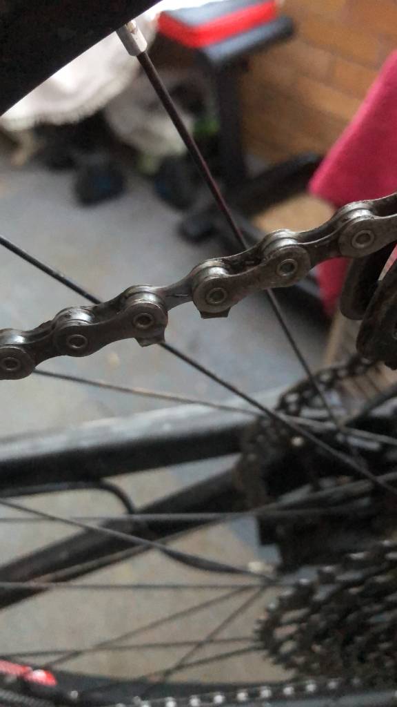

I recently finished a ride and spotted this;

I had a similar thing happen to a chain a few years ago. I was riding over some gravel and the drivetrain suddenly jammed. On closer inspection, one of the outer plates of the chain had been bent outward. The only thing that I could conclude was that a small flint with a sharp edge had got flicked up and jammed between the chain and rear mech.

I noticed that the bent part perfectly co-incided with a tooth, so that's clearly what caused it to bend. Maybe the mech got hit and jammed the chain onto a tooth at the same time as the pedal dug into the ground and put loads of force into it. That's my best guess.
