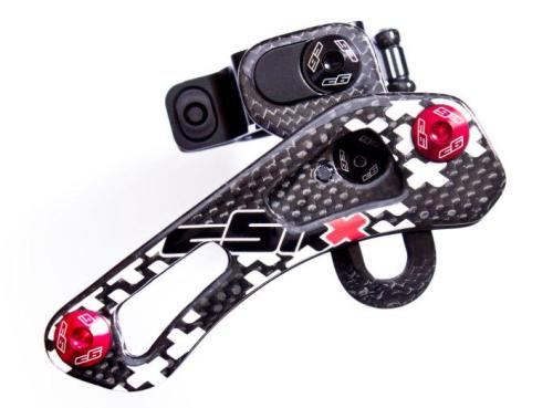

I've got a wierd set up with Rotor Cranks and a 'Plastic' frame (that has a different chainline to the seemingly industry standard HT2/Middle ring chainline)so the lateral adjustability of the Superstar was what drew me to it.
The first one bent, the second one bent, I bent it back and fashioned something a little bit stronger using various bits of 'plastic' rod...it's now lighter and stronger and hasn't bent 🙂
But this is the one I reeeeallly hope santa brings me next christmas 🙂
http://www.xcracer.com/shop/viewproduct.php?productid=279
[img] http://www.xcracer.com/image.php?imageid=1913 [/img]
Posted : 24/01/2013 8:40 pm
Seen that but £100 is a lot as well. I have just seen a dmr one that looks so simpe its got to work!
