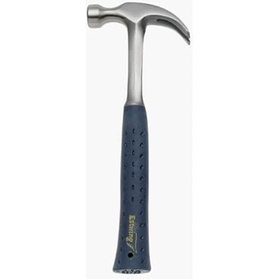

I have used mine on my and mates bike I reckon about 10 times now at least so its paid for itself several times over 🙂
[center][img] [/img][/center]
