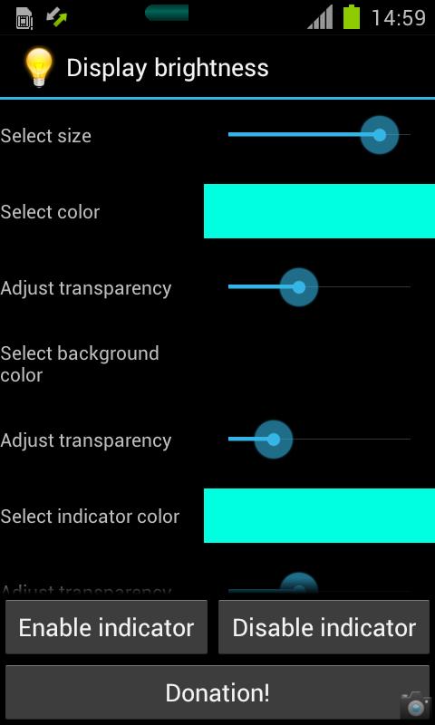

Any OruxMaps users found a cursor that is actually visible?

Posts: 497
Defy has no power button on front to wake so while mounted in a protective case I had to leave it on high brightness without the screen timeout, seemed a bit of a waste.
this [url= http://www.rubberbigpepper.com/en/node/365 ]handy little app[/url] will adust the display brightness with a touch slider on the screen, I found it easy to use while riding along 🙂
[img] https://lh3.ggpht.com/dDdfF1Q7AQ6GgLxZo4cv7rafAtZIh5NpLf4UTH_nUSD5PlEdMGJXMe1wNjh2-UN5-R4=h900 [/img]
Posted : 08/11/2013 11:30 am
