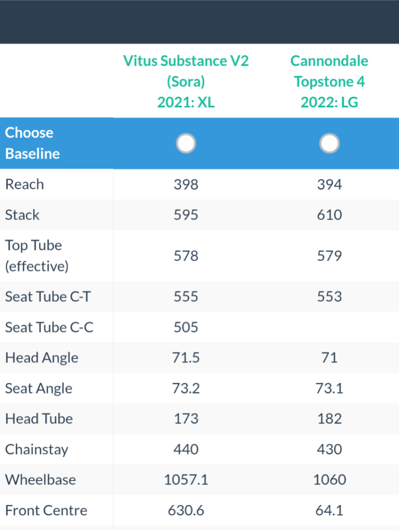

Posts: 3058
So the large topstone feels comfortable for me, but my XL substance doesn't. The topstone is 25mm higher in stack height. I cannot go any higher on mine without a high rise stem or riser drops unless I'm missing something

Posts: 9200
Posted by: bikerevivesheffield
The Topstone frame is 15mm higher stack according to your table (595 vs 610).
Presuming same bar dimensions; 30mm spacers under stem on both bikes; stem 110mm +6 degree on Topstone...

Posts: 3058
Had a play around - lowered seat 5mm, made it level (was tipping forward before some how). Played with bar height and reckon I need 5-10mm max BUT my brake hoses would be super tight!!!
When I get time I'll sort by ordering one of the adjustable spesh stems and sort the hose length

Posts: 3058
I have taken the plunge and bought one of those Specialized adjustable stems with shims. Went for the 90mm 24 degree stem and have used the 4 degree shim.
This has given me 31mm more height and 12mm more reach. The reasoning for going for the 28 degree rise initially is that is the most extreme and consequently the longest taht the hoses need to be and whilst in the process i had to increase hose length so went with the longest to start with, i can then if need be, lower the rise etc without having to mess with fitting more hose and bleeding the brakes again. I will have a ride and see how it fairs, when i'm comfy with the lever postition and bar position i'll do the bar tape 🙂
