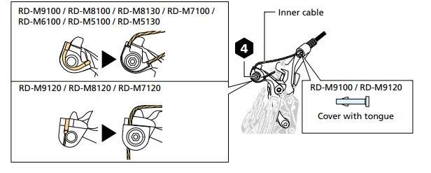

Cable routing should be
M7100

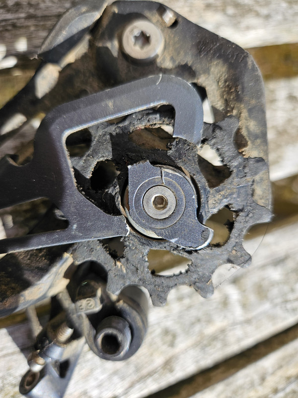

Had a quick look and perhaps I spoke too soon. Is that what people mean when they say the cage is being sawn through?
[url= https://tinypic.host/images/2024/02/06/Screenshot_2024-02-06-10-03-48-678_com.miui.gallery.jpe g" target="_blank">https://tinypic.host/images/2024/02/06/Screenshot_2024-02-06-10-03-48-678_com.miui.gallery.jpe g"/> [/img][/url]
Posted : 06/02/2024 10:09 am
Posts: 4626
No thats bad bTension setting - the cage saws through just above the lower jockey wheel. The chain jumps off the wheel and runs on the side, one side of the chain gouging the cage as it goes.

Mine failed like this:
broken mech cage
Posted : 06/02/2024 10:16 am
Posts: 4626
^ Thats the one, although this time on the upper jockey.
Posted : 06/02/2024 10:38 am
