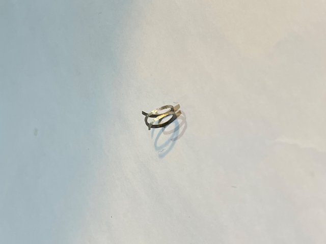

As title really. What is the best way to remove a (broken) heli-coil?
I have discovered one in my forks where the brake caliper attaches.
The reason I discovered it is because it snapped when I was adjusting the caliper. I was torqueing up the bolt and it went snap and when I removed it there was half a helicoil attached. This has been there since new which is a bit annoying as I am going to have to take the bike back to the LBS where I bought it and ask why there was a helicoil in my fork in the first place.... Bike is 10 months old. No doubt they'll say I put it there but we'll see....
Anyway what is the best (cheap) tool for the job...?
Ta

Can you see the other part of the helicoil?
Odd for a helicoil to snap halfway?
Could it be just a short helicoil?

A lot of aluminium parts have helicoiled threads as standard as it prolongs the life of the thread and if done properly is often a more secure fastening. You can normally pick the leading edge out of the thread and get hold of it with a pair of long nose pliers, then unwind it in an anti-clockwise pulling motion. I would leave it to your LBS because unless you have another helicoil and an insertion tool handy there is no point in taking the old one out. The helicoil thread may also be damaged and may need re tapping which requires the helicoil tap.

Run a normal M6 tap into it, it normally picks up on the helicoil when you try to unscrew it, and removes it in the process.

It’s absolutely common to use helicoil inserts in aluminium and magnesium castings. When fitted correctly it’s considered the better solution. They get a bad rep because they’re often badly fitted to bodge a repair in an expensive car part to avoid replacing it.
The problem isn’t that a helicoil has been used. It is a problem in that it sounds like it wasn’t fitted correctly.

Hmm OK then. I'll see if the LBS can sort it. I swapped the top and bottom bolts over and it has screwed up to the correct torque now without spinning so safe to ride. I'll take it out tomorrow after my ride and have a closer look at it. It was fitted as standard from new as I've had no repairs done on it.

Torque wrench. I'm thinking it might be the internal thread though now rather than a heli-coil as it is quite pliable. It's just teh way it gave way was odd. There was zero sign that it was cross threaded as it went in and in fact I hadn't taken it all the way out - just loosened it so the caliper would move and I could centre it. I was tightening it back up and it just gave way and started spinning freely.
One of these torque wrenches in fact https://www.wiggle.co.uk/effetto-mariposa-giustaforza-ii-torque-wrench-bits-1
doing it up to 7Nm as specified in the Shimano manual.

Are helicoils steel? If so you could see if it's thread damage/helicoil with a magnet?

Helicoils are almost always stainless steel. That photo above looks like the remains of a stripped alloy thread.

What brand of forks? That does not look like a bit of a Helicoil.

They are Suntour forks. My thinking now is that it's stripped thread. It's too soft to be a helicoil. I haven't dismantled it again yet (job for this afternoon) but assuming the thread is now knacked is fitting a helicoil going to be the solution?
Also, if you can fit a 20 mm larger rotor, you could try cutting the head off a long bolt, so you just have a threaded stud (do this for both mounting bolts).
It already has a 203mm rotor on it (with an adapter). It does only seem to have stripped a bit of the thread though as I did manage to tighten it up again - I didn't dare touch it after that as I wanted to ride this morning so I will take it apart now....
Are helicoils steel? If so you could see if it’s thread damage/helicoil with a magnet?
Good shout - I'll try that too but I'm 90% sure it's thread damage now.

So it seems that when I dismantled the caliper fitting previously to bleed the brakes I swapped the bolts over by mistake and put the shorter one at the top. It tightened up OK when I put it back together but when I tightened it up this time it has stripped the top few mm of the thread as the bolt was too short to take the load. 🙁 This explains why when I put the correct bolt in the top it tightens up OK as there is still thread lower down. There seems to be less than a third of the thread missing when I look into the hole and measure it against the bolt so I am hoping 🤞 that I can leave it like this without fitting a helicoil as TBH I'm not looking forward to drilling the fork and then tapping it in case I get it all crooked. I don't have a vice or a drill press so it would be a manual job with it on the bench.
