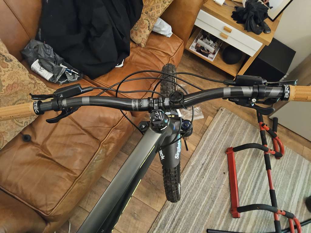

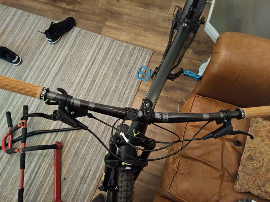

Hey guys.
First time doing this.ย  Does this look okay?
I put gripper gel on the stem clamp and on the grip locks.ย  Gently tightened criss-cross and stuff.ย  Getting a torque wrench to use on Friday to ensure not overtightened (have a history with road bike seat post clamps)...

Your bars look like the could do with rotating fwd a tad.
Could also move the levers away from the grips to give yourself some more leverage on them.
Is that what you meant?
Posted : 11/03/2024 11:32 pm
Posts: 9065
Definitely slide the brakes inward and wind the lever blades in if you can, they look miles away from the bar.
Handlebars have 2 bends in them. One upwards and one backwards. I always start with the upsweep vertical so if you look from the side of the bike the face of the bar is upright. This points the grips up and back towards your hands.
Final wiggles will be personal preference.

Okay.
Yeh that's what I was after guys.ย  I was unsure about the position of the brakes.ย  I will move them and try rotating the bar forward a tad.
What do you mean by wind in the leaver blades?ย  As in tighten them!ย  How would I do that?

Some brakes have a reach adjustment option. Usually it's a small knob or an Allen key to wind the lever in or out. This usually depends on size of your hands/fingers and personal preference. If you have small hands, your arms will fatigue more quickly on long downhills when your fingers have to stretch to cover the brakes so, generally, wind the lever in for smaller hands.
Some (more expensive) brakes also have a free stroke adjuster which allows you to find tune the dead zone between covering the levers and the brake pads actually engaging.

Rotate the bars to whatever position is comfortable for you. There isn't really a correct position. I like to have them set with zero upsweep, other people differ.
Similar with brakes, just move the levers inwards until your finger/s fall naturally onto the end of the lever. I prefer having my levers fairly flat (i.e. not angled down too much.) It makes them easier to reach when you are descending with the saddle dropped.

Wound the blades in.ย  That makes such a difference.ย  Rotated the bar, sits higher and moved the brakes.ย  Feels so much better.ย  Thanks for the tips.ย  You tube really is a fountain of knowledge and visual aid...
