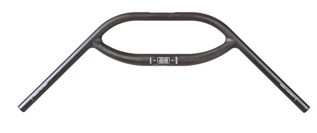

I've used jones bars and found them far too backsweepy... now (for longer rides) I use the alpkit ones - it's like a straight bar but with the loop 'added on'... pictures will make it obvious what I mean.
can almost do most of the riding on the various loop areas, and it's much more comfy.
Sonder/alpkit bars
Jones bar.

I didn't get on with a Jones loop on my non-Jones frame, but feel like I need more than the few degrees I have now. Others seem to agree. (Edit: exactly as DrP, I switched to the Alpkit bars because I like the loop. Something between those and Jones, backsweep-wise, but with a loop would be ideal I think.)

+1 for more back sweep. Bar flex is a vital part of bike comfort and IME the loop type bars DrP posted can be too rigid. I've done a lot of long days on Jones Loop bars but I find the old Ti H-bar (no loop, also shimmed 25.4mm centre) much comfier. I tried the MTB loop bar (upper one in those pics) for 2 rides and found it horribly stiff.

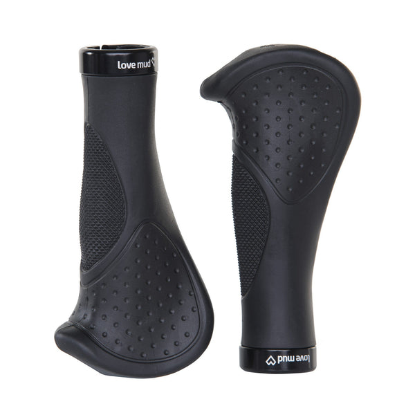

Alpkit/Sonder have a love mud shaped grip which I really like for longer rides. Not expensive either.
https://alpkit.com/products/love-mud-grasp
