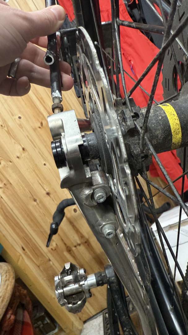

In my ongoing battle against tubeless setup, I had my rear wheel off my gravel bike to replace the valve. This seems to have sorted the latest pressure issue but I'm having a mare. I put the wheel back on, it took a while to get the thru axle in which is unusual but it now seems to be threading too far through and pulling the wheel to the left, with the brake housing rubbing against the rotor. So I must be missing a spacer of some sort but I can't find it anywhere and never had this issue before. I assume the spacer must be between the wheel and dropout but I don't even know what replacement to order.
The wheels are Mavic on a Dolan bike, photos below (hopefully). Any thoughts? I'm really stuck. Ta.

End caps? What are end caps? I've not knowingly taken anything off or swapped anything, I just removed the thru axle, took the wheel out, replaced the valve and topped up sealant then tried putting it back together.  I assume I have lost something else in the process.
Rotor has always fitted in the caliper without any adjustment, but tonight the thru axle just seems to be pulling the wheel too far over to the caliper side.

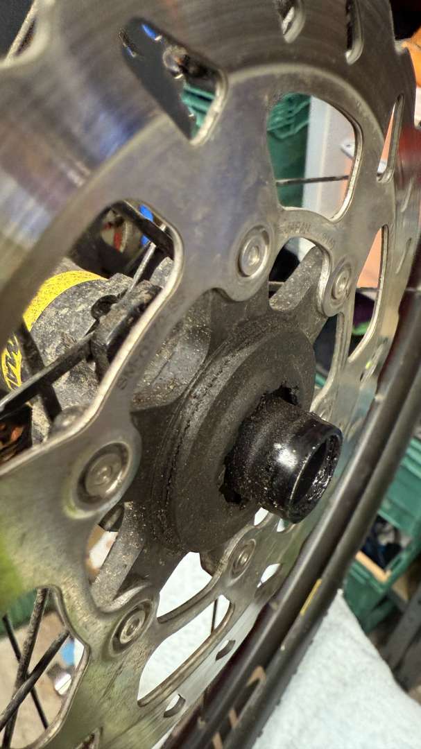

Maybe some photos of the disc side of the hub with the wheel removed would help folks diagnose the problem better?
Have you measured what width the hub is now?
That'd diagnose if there was a spacer missing straight away.
Poke something like a pencil through the axle hole and put a mark on it either end then measure that for an easy way to measure the width.

Yep, missing end cap seems to be my problem. End to end measurement is 138mm, any suggestions as to how I work out what I need to order?

Tredz have these. It's the split cap that's missing. I tried to post a link but failed.       Mavic QRM Auto Rear Axle Adapters - 12x142/148/157mm

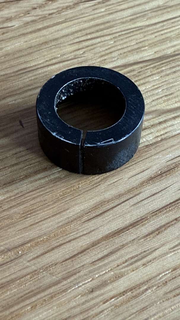

Posts: 9542
Posted by: blaggers
If you’ve not removed any bits and it was working ok before, you’ve probably dropped the end cap on the floor. Just find it and refit it.
The perils of a gravel drive and messy garage, but got there in the end! Glad I didn’t pay £16 to replace this
