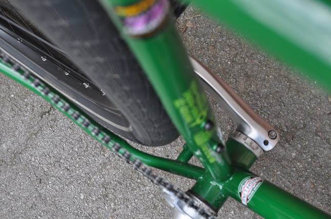

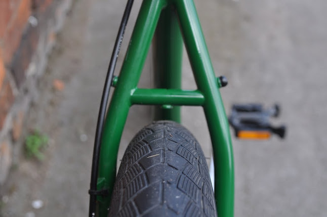

I had 2.35 Big Apple, now Smart Sam 2.1 with full length mudguards - should have enough clearance, anyway you could use halflink to fit the wheel further away I guess...
Posted : 29/03/2013 2:32 pm
That's the Big Apple with the wheel all the way in:
HTH
Posted : 29/03/2013 2:34 pm
Posts: 108
Top man kazafaza, mind thourougly put to rest now. Excited now
