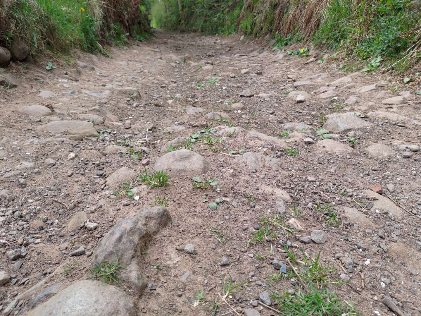

I had them checked - too much grease in negative chamber, but bushings were fine, also they bled the damper.
They don't seem to be any better, well I can't do a back to back test anyway.
Brutal on my hands on this track at 30kph/18mph, tried all sorts of settings. Best I got to was 70psi (less and more is worse), rebound -8L/-7H (a bit fast), LSC and HSC full open. Used 120mm of travel which is about what I'd expect.
It's perfectly fine on my normal bike - Selva R, same tyre (Wild Enduro Front Competition Line), 20psi (21psi on the eBike), same insert (Rimpact Original), Pro4/XM481 (Mavic E-Deemax SL o the eBike).
My suspension guy was saying (not about this particular track) I'm running tyres that are too undamped, too low pressure, and the ground/stones may be hitting the insert.

How much do you weigh?
70 psi suggests not a huge amount which makes me think (contrary to your suspension guy)  - your tyre pressures are pretty high! 21 psi, with an XM481 rim AND an insert? I've no experience of the Michelin tyres to know what they feel like.
I weight 80kg, and on the front of my ebike is also a 36 Grip 2 - also an XM481 rim, a Schwalbe Super Trail casing tyre but no insert and I run 18psi . Thats considerably softer than 21 psi - I know for a fact that if I ran 21 psi my hands would be feeling it.
I'm no loic bruni but I'm not pootling either, thats for proper enduro lines, rocky stuff etc.

Maybe try it without an insert? That's ~200g of unsprung weight hammering around on the end of the fork.
Posted : 28/04/2025 11:57 am

I did notice in repeated runs on that section of track that rebound a bit faster than recommended was more comfortable and used less travel, presumably keeping it higher in the travel where the spring rate is lower.
Posted by: snotrag
75kg plus kit.
Posted by: snotrag
Any less than 20 and they tend to burp sealant. There could be something in tyres, pressure, spoke tension, handlebar stiffness, but none of that feels like it's going to be enough to overcome the fork problem.

Tried that, doesn't seem any better although it was just during a ride rather than a repeated test.
I'm think I'll take both bikes somewhere to test back to back, to check I'm not imagining things. Or I wonder if those first few weeks with the 36s and evening pains some days have caused me to become more sensitive now.
