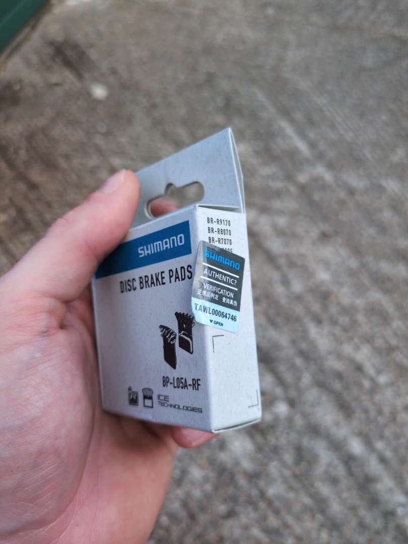

Today I read road.cc's article about fake Shimano brake pads. They look the part and appear to work fine, until they get too hot and the pad falls off the backing plate! Potentially causing a catastrophic failure:
Before I knew any better I also bought some L05A-RF brake pads off eBay, from a seller called Cyclinghome_uk (they have since changed their name to hopeus). The seller has over 99% positive feedback.
Luckily I haven't put them in my road bike yet, so decided to take a look to see if I could spot any obvious signs of fakery.
The box looks and feels absolutely perfect, but peel away the "Authentic?" sticker and there is no barcode to scan!

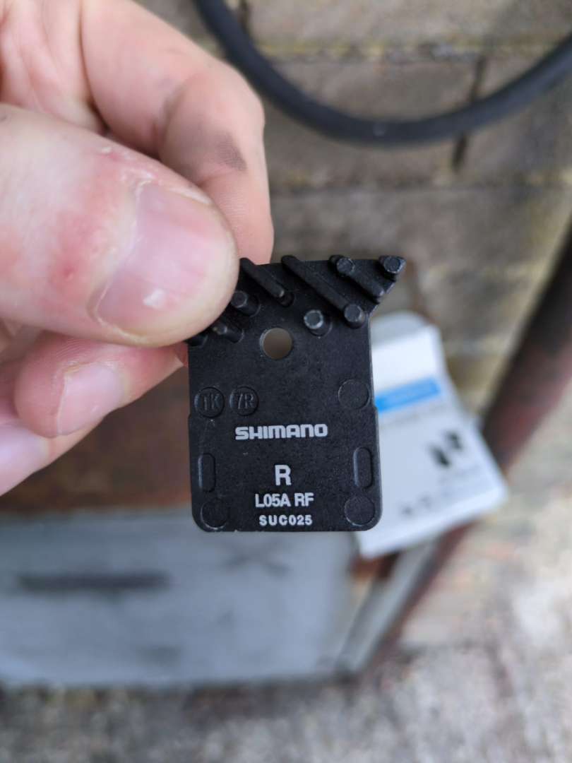

The back of the pad matches genuine ones from pictures online, apart from one tell - there is no "bobble" in the middle strip at the top, where there should be:

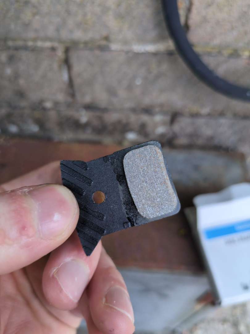

Finally, a tell on the front is the residue all over the plate
These fake ones presumably work fine most of the time, until they suddenly don't! So lesson learned and I will only be using proper bike shops and suppliers in future.
