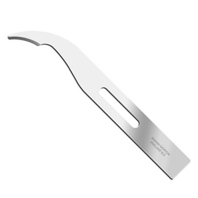

I use a stitch cutter blade to trim the tape, use a mixture of Specialized and Stans valves. Never had one leak

@ Tracey, I've got similar, I have a Swann Moreton 11 scalpel blade which has a rounded cutting tip.
Posted : 17/01/2017 1:25 pm

People make cutting the valve hole really complex for themselves sometimes, I just get it stuck down then run a scalpel blade around the edge of the hole, can't fail to get a perfect cut (as long as the tape is stuck down!)
