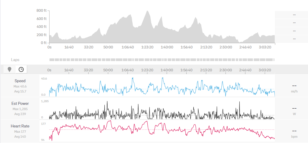

A mate posted this as pretty much his first ebike ride. Its a Amflow. So I’m going with yes
 Image upload broken
87km 1600m ascent

Posts: 9210
It didn't quite meet the OP's spec, but I managed a 50 mile ebike ride yesterday with ~3200 feet climbing, surprisingly only using 81% of the 248Wh battery on my Bolt.
3hrs12mins total time, ~15.7mph average
Vast majority of ride in eco mode (set at 75W)
Tiny bit of mid assist @ 140W, approx 2mins max of assist while activated for ~5mins
Turbo @ 250W, ~24mins of assist up four cat4 climbs and a few short steep ramps, while activated for ~34mins
Because of the rolling terrain in the Hampshire South Downs, I was above the motor cutoff assistance of 15.5mph for at least an hour (probably a bit more, no easy way of calculating this I can see on Strava), on descents and essentially flat road.
But the important factor was that pretty much every time I engaged turbo, I was often going threshold or beyond with my heartrate, rather than gently spinning an easy gear... That ~24mins of actual motor use would have used ~40% of the battery!
Posted : 11/08/2025 3:24 pm
