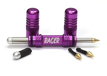

Saw someone use a Dynaplug Pill on holiday and it's impressively quick and effective compared to messing with the cheap kits.
However, the Pill is over £50 now. The 'carbon' ultralite looks bulkier but no heavier and it's only £19. Anyone seen one in the flesh?
http://www.dynaplug-uk.com/dynaplug-c-22/dynaplug-carbon-ultralite-tubeless-tyre-puncture-repair-kit-p-102

I've got this one myself, never had to use it but it's tiny so you can take it out in your pocket even if you're not carrying a bag.
Perfect for the minimalist explorer! Or just people like me that don't like carrying loads of stuff.

I struggle to see it's USP really, it's definitely marketed at Enduro, but....
The only advantage, unless I'm missing something, over anchovies is that it's a bit quicker, fair enough.
But on an enduro stage, even if you had it in your pocket, by the time you've stopped to get it out, and deployed, you'll have lost at least half your air volume, and yer time for that stage will be pretty goosed.
I don't see it being significantly quicker than a pre loaded anchovy, already on the wee insertion tool, in a pocket.
I'm perhaps missing something?.

I've got that purple one too. It's clearly a luxury but it's very quick to use. I wouldn't try to justify the cost but you get 5 with it and the refills aren't crazy money so it isn't a tenner a go.
I've used many anchovies in my time and this twice. This is of course quicker but then anchovies aren't slow. And I'm not winning any races anyway. The dyna plug does give you two sizes as well and I've never carried anchovies as big as the big one. That said, unfortunately one of my recent flats was a tear too big for either.
So yeah, it costs more but is a bit better in my view.
Edit: I can't see it saving 15 mins either. It doesn't need glue - supposedly the stickiness that's on it already is enough but I haven't used it enough to know for sure. Anchovies I've always been happy to leave in for the rest of the life of the tyre.

The other kits look interesting but I don't like the idea of that bit of metal stuck in the tyre. I would be concerned about it hitting the rim.
Probably totally irrational concern though!

Does the pointy thing stay on once in the tire? And if so, how does that work if you at a later date need to chuck a tube into the tire?
Posted : 30/06/2017 1:39 am
Posts: 30
Yea it stays on. So would affect fitting a tube. As said you can get round ones, which are a bit kinder!
Means either removing plug or cutting the brass off leaving the twisted black section.
