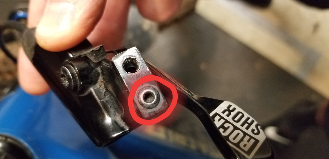

I had a bit of a crash and when I picked myself and the bike up, the Reverb lever was dangling loose - the bolt was pulled out of the mount and has stripped the thread (upper hole in the photo below).
But is the second bolt (highlighted) another mounting option? If so, does it only work with certain clamps (if so, what type?)
If not, what is the highlighted bolt for???
I stripped the thread

You can use that, the 2 holes are so you can mount closer or further away

Alternate mounting, to allow you some lateral adjustment to avoid the brake lever clamp. At least thats what I did, 7 rides in and it hasnt fallen off yet.

Thanks and good to know!
Now if only I knew this yesterday when the crash happened - I wouldn't have had to ride out with the lever dangling around and the dropper in its lowest position! Doh!
