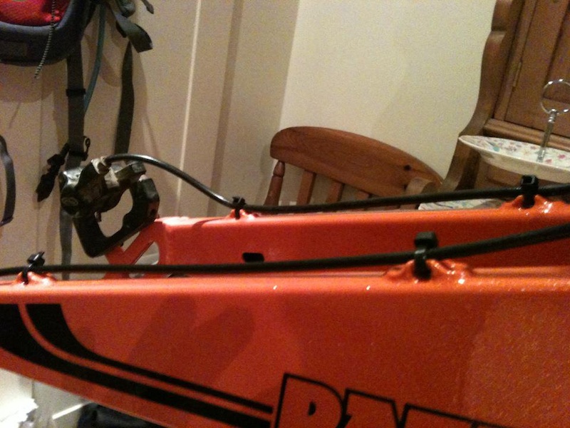

I used Araldite for securing the hose guides, before sending the frame to the powdercoaters. Not a bad job I think!
You can see the hole in the swingarm where the internal routing exits.
Posted : 30/10/2013 11:57 am
