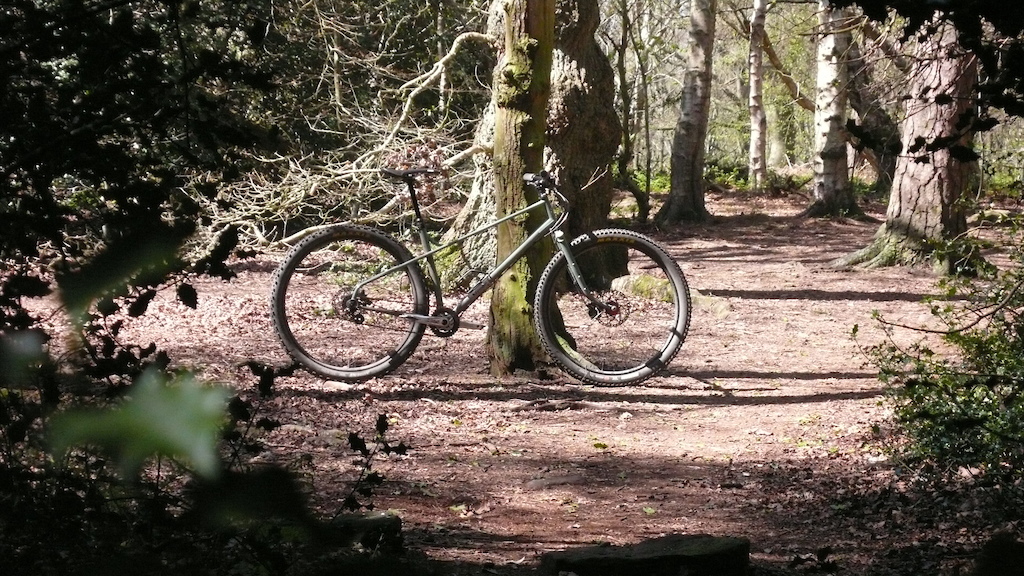

A couple of my single speeds to lighten up the thread

Some lovely looking bikes there! Is that your tools in the bottle cage?

Thanks @shermer75
Although I should say, I hope you realised the bottom (nicest) one isn't mind. And yep that's my tool bottle

Ahhhh Hot Mama!
That green ss machine is rad to power turned up to 11
