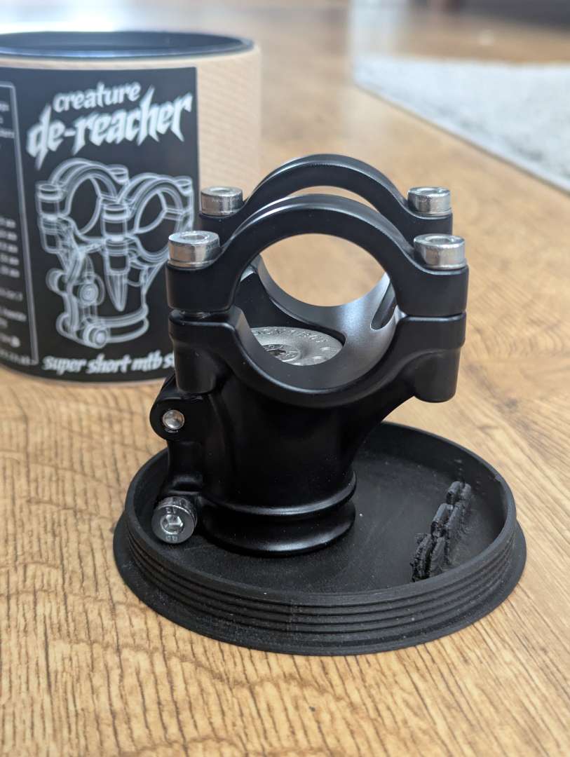

Still rulezman ish money but at least the price is inc VAT, and it’s made here.
https://creaturecycles.co.uk/product/creature-de-reacher-super-short-mtb-stem/
Posted : 15/02/2026 10:06 pm

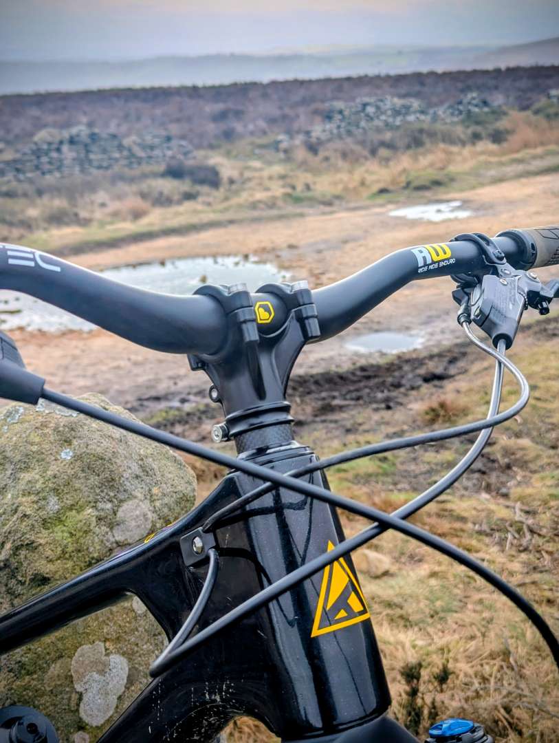

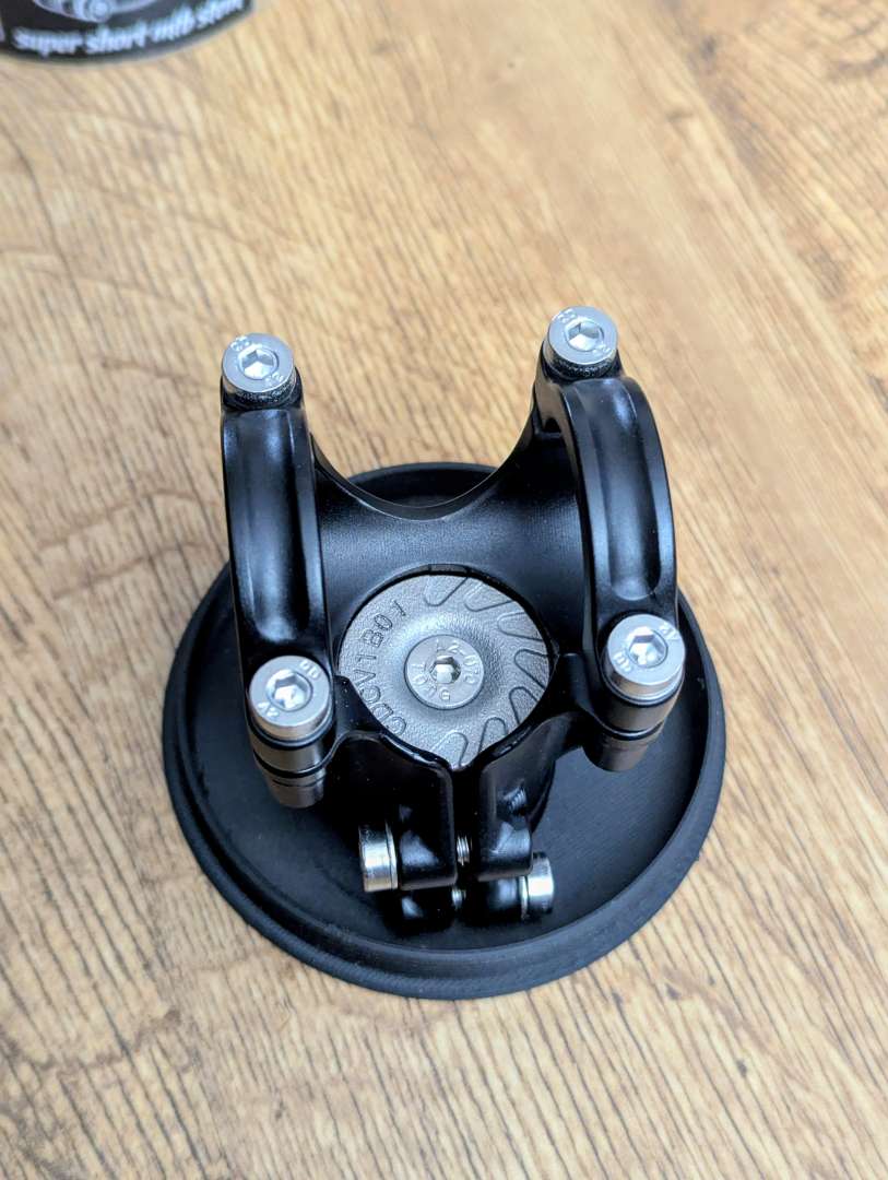

So this just arrived. The new guitar will have to wait another month.
I might actually have to ride my bike now and see if it works.
Luckily I think I have the perfect bike for it.
Posted : 21/02/2026 12:08 pm
Posts: 21098
Nice!
*whispers quietly about being excited to try the Rulezman I’ve got, waiting for the frame to put it on, the direct mount one on the Gasser has been ace though!
Posted : 21/02/2026 12:20 pm

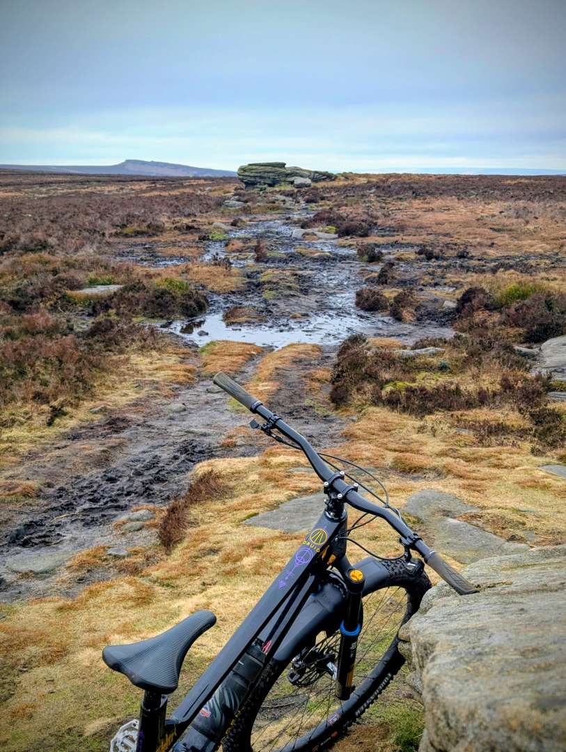

Posts: 9225
I actually rode my bike today. I headed for the hard pack, sandy trails of the eastern Peak and found bogs everywhere. I ended up doing a couple of Lady Cannings laps.
To be honest I forgot about the stem instantly.
It's the most comfortable seated pedalling position I've ever had. It reminds me of when I went from and old school 26" hardtail to the Geometron in 2017. It's that much of an improvement.
Handling is fine really, not much to report. It's one of those things that looks weird but you get used to instantly. I suspect the biggest shock will be when I jump back one of my other bikes.
I was apprehensive about cutting the steerer right down but I think I'll remove the last 10mm and run it slammed. It can easily go down a bit and still be comfortable.
I need to ride some steeper, challenging trails to see how it is on the fun stuff. I was expecting it to understeer or wash out on the flatter, gravelly bits of LC but it was planted.

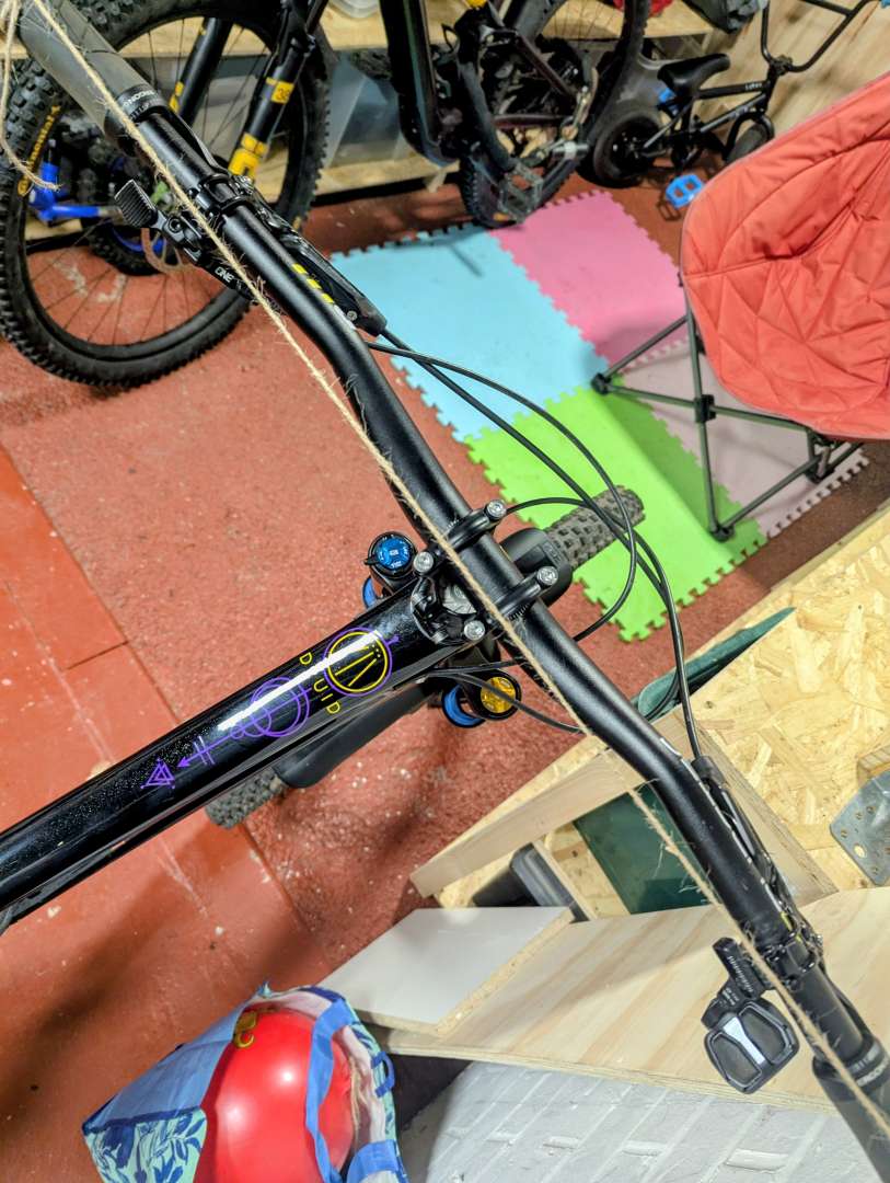

Posts: 7087
Nice.  Where do the grips end up in relation to the steerer tube?
Posted : 02/03/2026 9:23 pm

Posts: 9225
Posted by: BruceWee
It's hard to take a picture of it but the tips of the bars are a few mm behind the steerer and my hands/thumbs are almost bang on the line.
I might go full Reece Wilson and run it backwards.
