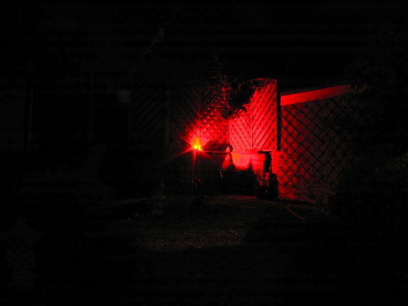

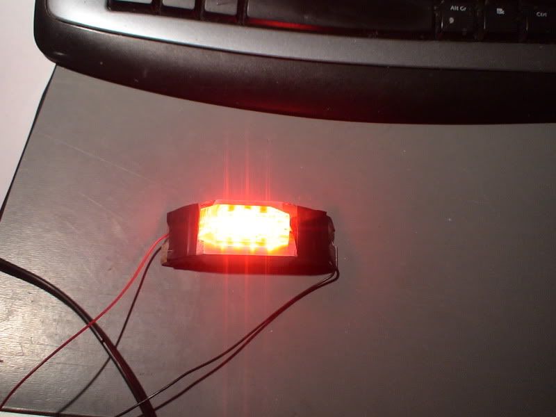

Do you mean a tail light like this
and that is on low

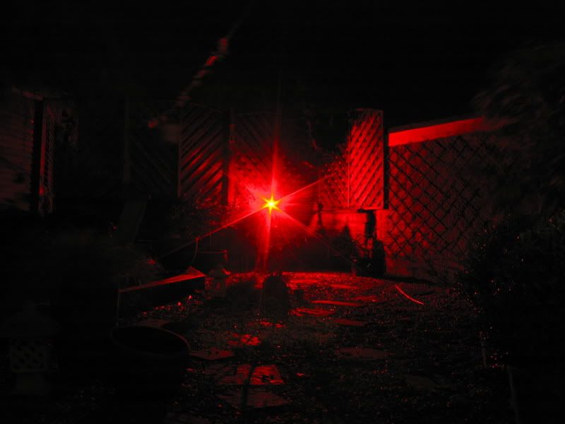

Get your selves a few red ones and build an easy rear light
and at 180 degrees to the light and 30 metres away
