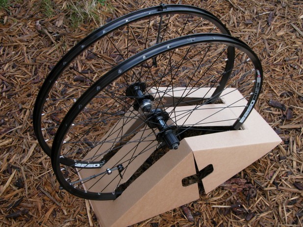

Get some of the on-one 29er wheelsets. They can take a pretty thin tyre on there. Mine seem to be lasting and spinning quite well.
Posted : 13/12/2010 11:47 am
