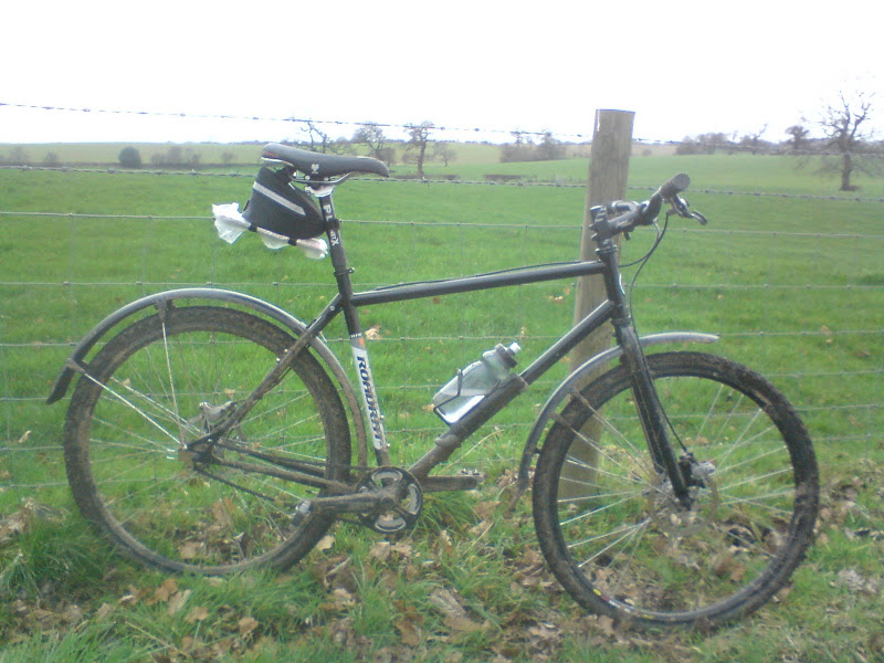

I ran my Rat with 26" and discs - just 'cos that's all I had available. It was absolutely fine - fast, 50psi + in the tyres (1.5" cheapo centre ridged hybrid tyres from Halfords, then eventually some posh Conti ones) and I ran it singlespeed and 1x9. It always had discs on it - that was kind of the point of the bike, I thought, but it also allowed me to run full mudguards too. It was easy to set up, loads of clearance with those tyres on, and I can recommend it.
Not the prettiest of pictures taken a while back, but it gives you the idea...
(oh, I've learnt a thing or two about chain tension since then, too... ) ๐Ÿ˜ณ
