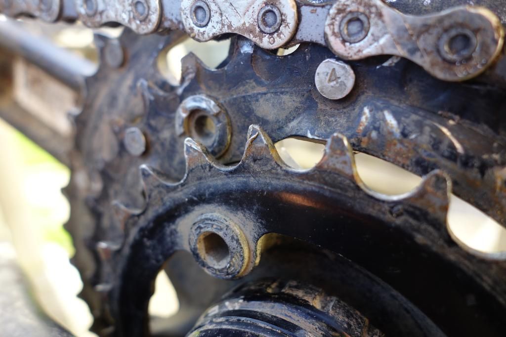

Mary Hinge - Member
Check the sides of the teeth on the chainring for burrs...
+ 1
This was enough to make the granny ring un-usable:
I filed it smooth, and harmony was restored.
Posted : 08/03/2015 10:31 pm
