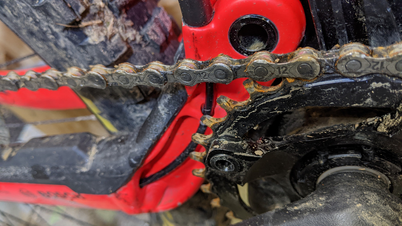

Posts: 18158
Putoline a day or so after a muddy ride.
Posted : 02/05/2022 8:35 pm
Posts: 44680
Yup - a bit of external rust - happens if you have peaty soils IMO - a wipe down with an oily rag and it will be fine. I bet there is still plenty in the rollers where the lubrication is actually needed
Posted : 02/05/2022 8:49 pm
Posts: 91157
That is also my experience - it's cosmetic. Chains still last ages despite that.
Posted : 02/05/2022 8:55 pm

The rusty chain thing is why I could never hand-on-heart say that Putoline is 'less faff' as my routine always involves a quick rinse with the hose after a wet ride to get anything corrosive off the chain (salt/peaty soil/whatever) then the wipe with an oily rag. Is still easy enough to do before you even put the bike away and it's worth it for the performance.
I do very much hand-on-heart swear by the extended life that Putoline (and presumably MSW) offers. I actually attempted to go back to drip lube last winter so stripped the chain back to bare metal (multiple soakings in white spirit etc.) and applied some Juice Lubes Viking Juice instead. I can't comment on the performance of the Viking Juice, as after half a ride I realised how shockingly worn the chain was, to the point that it was trying to chain suck on the equally worn 1x narrow wide chainring! I re-applied the Putoline and all the problems went away and I'm still using the same drivetrain to date with no ill effects.
(and for what it's worth I also like Squirt, I think it needs a couple of applications to properly build up on the chain, and once applied I'll never wash or rinse the chain but just wipe clean before more applications. I don't use it for regular wet or off-road riding though)

The rusty chain thing is why I could never hand-on-heart say that Putoline is ‘less faff’
I find I only get the rusty chain when riding in pretty wet conditions. A hose down of summer mud splatters doesn't do it. I've not touched any chain for a couple of months and I might do it once this summer on each bike.
