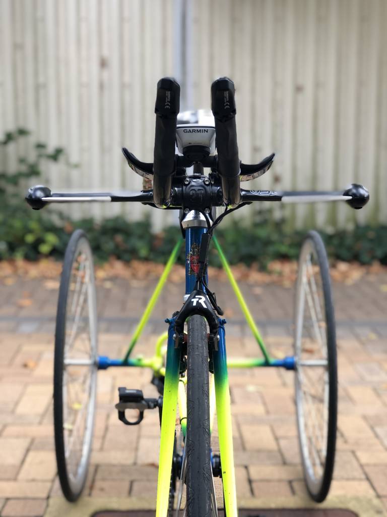

No thanks. It'll creak eventually. It's all down to how hard adjusting integrated cockpits has become. Personally, I am happy with the <1 Watt hit for visible cables. Seriously, it is unmeasurable in normal settings.
Power is 0.5*Rho*Cd*Area*V^3
Cables are basically straws with a Cd of ~1.1, Air density (Rho) is 1.2 kg/m^3, and assume 20 mph speed (V = 8.9 m/sec)
Power (watts) = 0.5*1.2*1.1*area*705 = 465 x Area in m^2
Assuming cables are  0.5 cm wide housing, so Area =  0.005*Length in metres and hence:
Power (watts) = 2.3/metre
If you have front cables (not hidden by other parts of the frame), of, say 0.5 metres, you are losing 1.2 Watts. On my TT bikes, I have placed any exposed cables in line with frame tubes - I also have aero brakes…ok ignore the back end
TT bike
