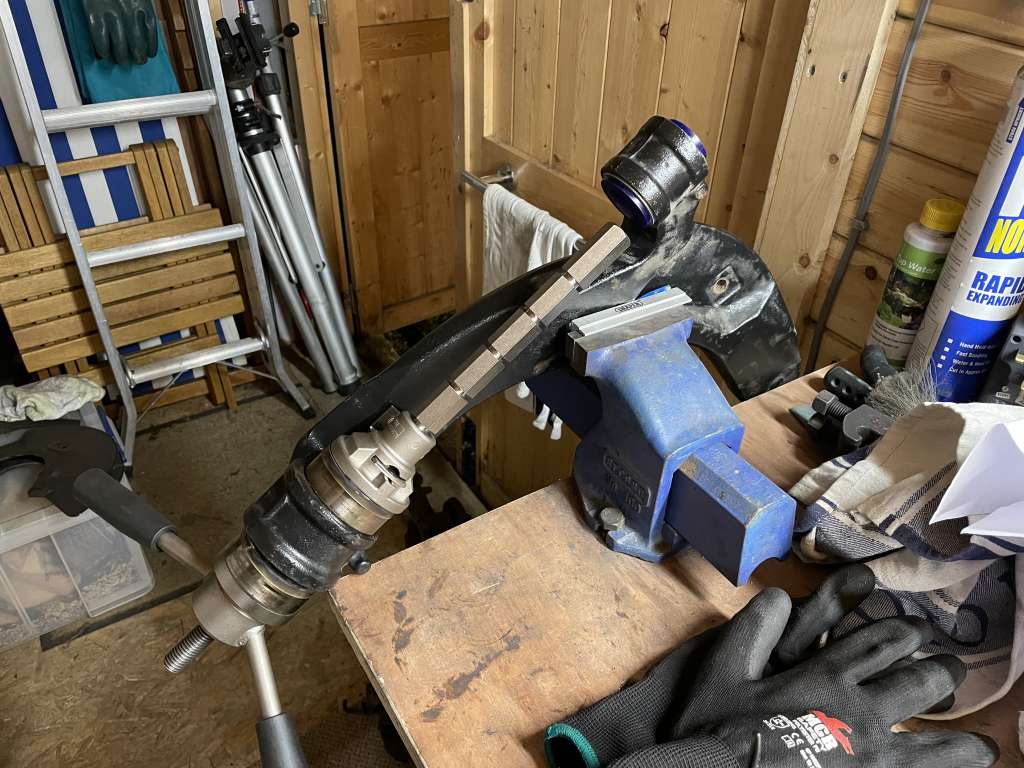

Depends how big you need.  I have a Park Tools headset press that has fitted two headsets in 10 years, paid for itself the Spring when it fitted polybushes into my Caravelle front wishbonesIMG_3885
