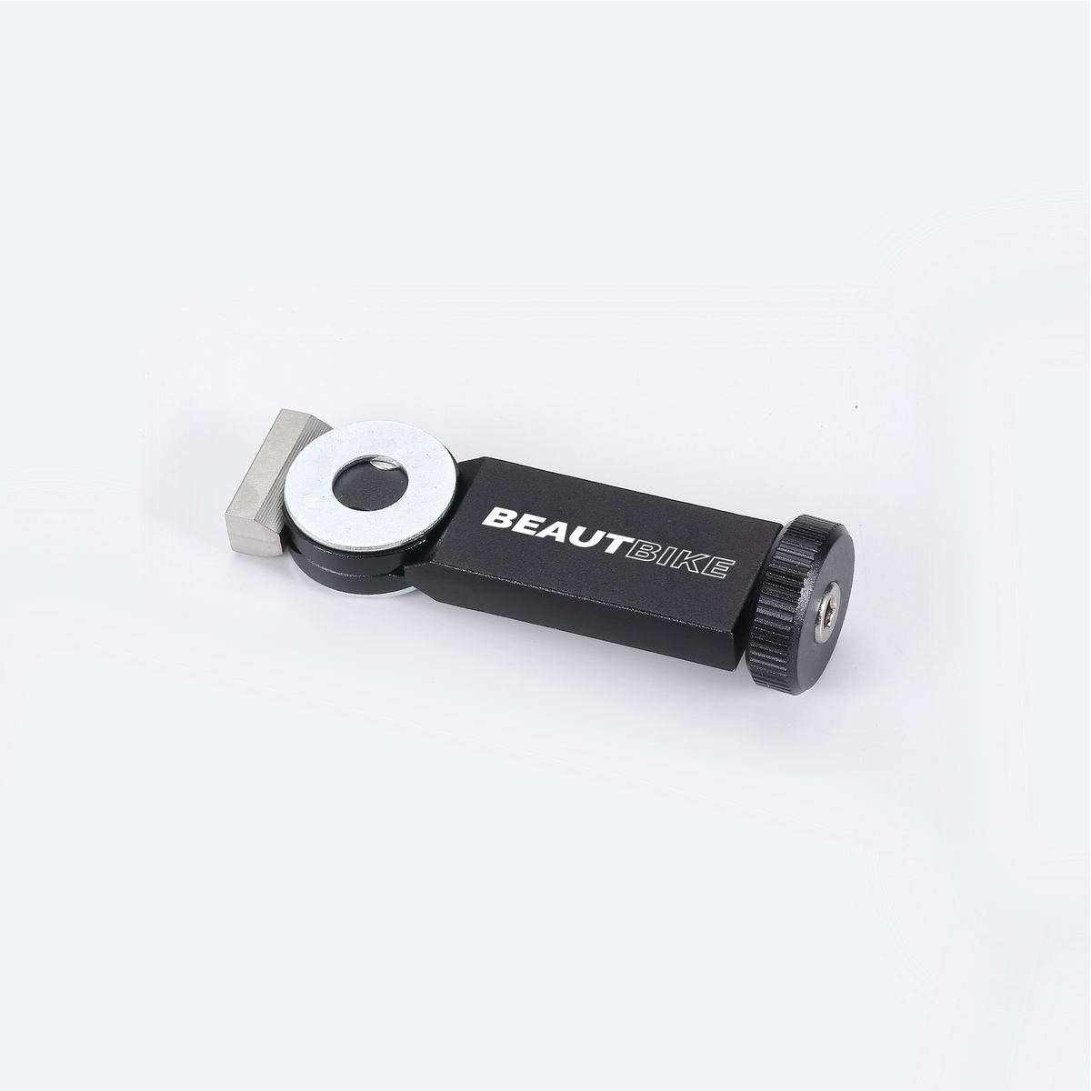

Posts: 4506
Dave Rome was very positive about these on the Geek Warning podcast recently.
https://www.beautbike.com.au/products/mini-bicycle-disc-brake-piston-press
He says he's going to do a proper review of them soon but basically said they're more versatile than the SRAM ones and don't fall apart like the imitation SRAM ones.
I don't think they ship to the UK yet but hopefully it's a matter of time.

That looks to be the Sumart one rebranded. Out of stock currently.
Worth noting that you need two for 4-pots and even then they may not fit (eg Magura).
