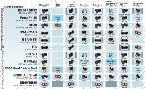

The frame this is going on has a threaded BB shell, but BB30 is different as I understand it. I'm guessing (hoping) that the axle of the GX crankset will be compatible with the deore BB that's in there at the moment, so I can ignore the SRAM BB? Or is it just a case that the crankset will not fit this frame / bb combination?

BB30/ PF30 = an axle width of 30mm
Shimano = 24mm

Can you get BB30 cups for threaded BB shells?

It would appear that this is what I need? Is that correct?
http://www.wiggle.co.uk/race-face-bsa-cinch-30mm-bottom-bracket/

Hope do a threaded 30mm BB
[url= http://www.hopetech.com/product/bottom-bracket-30mm-threaded/ ]Hope BB[/url]

[url= https://www.sram.com/truvativ/products/gxp-bottom-bracket ]https://www.sram.com/truvativ/products/gxp-bottom-bracket[/url]

Don't think the SRAM GXP will work with the 30mm axle. You may be better off with your cheaper option assuming its not busted
