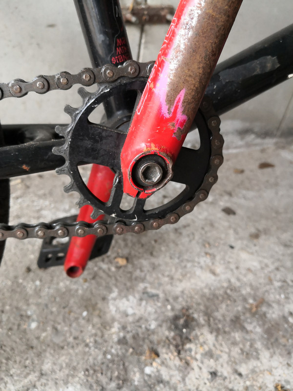

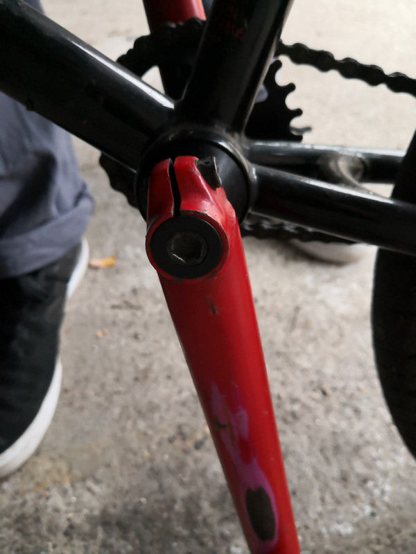

Stripped, cleaned and regreased and everything seems quiet.
Weirdly the spindle seems too short, if it's pulled tight to the driveside crank the non-driveside is only about halfway on. Everything seems solid with it pulled evenly on both sides, but it's a bit odd. Is it supposed to be like that? Not running any spacers, just the covers and if the cranks were any further in they'd be too close to the stays.
Posted : 20/06/2020 1:26 pm
Posts: 656
Pulled evenly both sides and all bolts nicely tight is how it should be. If the end of the axle is outside the pinch bolts then it's fine
Posted : 20/06/2020 1:48 pm
