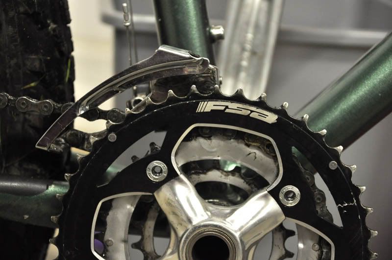

I wanted to check something, the clamp on the upright has Deore on it but the part that shifts the chain is a FSA item- is this normal?! here is a pic:

That front mech is bent. The outer cage has been pushed upwards.. Usually by the chain running up underneath it. The top bit, with the mega 9 sticker should be flat. Also, the pivots should be parallel to the chainrings. It might be twisted back a bit there too.
It'll take a careful hand to straighten it, but it's doable.

Looks like both mechs got bashed in transit 🙂

Your deore deriller would work fine with thoes cranks if it wasn't bent so badly out of shape.
Also from that pic it looks like you might have a cracked big chain ring 6 or so teeth round from the A of FSA

That's just a scratch on the ring.
TBH, those mechs are always a bit pants and prone to bending and rattling, and they're never as good again once you've straightened them a couple of times. I'd shell out for a conventional style (bottom swing) SLX or XT one and you'd be sorted.

Also, i'd drop that front mech down a bit on the seat tube clamp as you may find that with the chain in granny, the mech is too high to work to keep the chain in granny.
