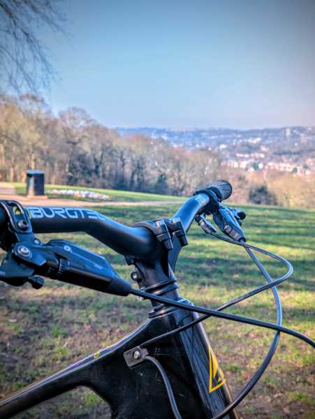

Posts: 6963
Also currently experimenting.  100mm rise Ergotec bars paired with a 30mm stem.  I rolled the bars back a fair bit so now the grips sit behind the steerer tube.  In addition, I've also started playing about with crank length.  I'm currently running 140mm kids cranks.
The cranks make a slight difference to the standing position (and also makes it easier to switch stance) but the main difference is the seated pedaling position.  Since the cranks are shorter the saddle is higher so it doesn't feel quite so much like riding a chopper.
Also, no pedal strikes since fitting the cranks.
Overall I'm happy with the way it feels.  I was always worried I was going to lose front wheel grip if the bars weren't as low as possible but if anything the opposite is true.  I'm not quite sure what the physics behind this is, tbh.
Started doing this after watching some of Reece Wilson's videos:
Posted : 16/03/2026 7:47 am

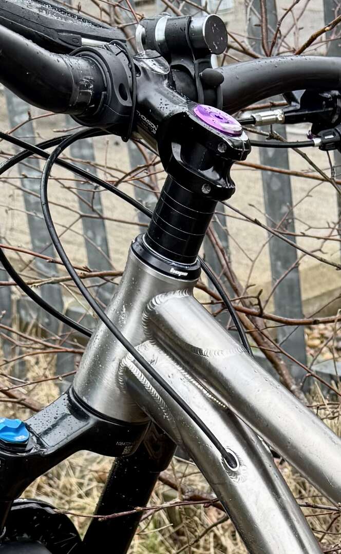

Posts: 9065
Posted by: bikerevivesheffield
@sharkattack what's that stem mate
https://creaturecycles.co.uk/product/creature-de-reacher-super-short-mtb-stem/
The downside of experimenting is the price! Still, I've got the perfect bike for it and I already have a few different bars to play with.
I like the look of the Itend stem but it's a 2 bolt clamp so you can't put high rise bars in it. I knew about the Rulezman stem previously but it's 15mm reach and if I'm going super short I want all the shortness!
This one is 60mm high with 10mm reach.
Posted : 16/03/2026 4:48 pm
