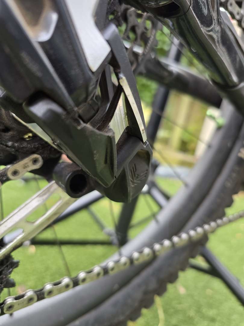

Anyone had one disappear?
Gears have been working well for a while, but went to shit today. Just a case of torquing everything back up.
But whilst trying to go through the correct procedure, noticed my setup key has gone.
They don't seem too readily available either when searching Google. Ordered one from Lordgun

Posted by: DickBarton
What is a setup key?
What Pauly said (I think, maybe) and it also holds the mech in certain positions when setting everything up - goes where that black hole is in my pic

Posts: 7383
ooh, it's also the "clutch"/lock mechanism that holds the cage down for taking the wheel off. Bit mad that it can just fall out!
Did you switch it from A to B (or viceversa) and not click it back in properly, maybe?

Posts: 14725
Posted by: desperatebicycle
I remember making sure it was in the correct position for the bike AND clicking it in some months ago. All of a sudden it's gone. Who knows mate, I'll have a good fiddle when I fit the new one

Posts: 1204
@desperatebicycle I don’t think the cage lock is related to the set-up key.
Also, if you’re travelling with your bike for any length of time make sure you remove the AXS battery as they’re motion sensitive.
Posted : 08/09/2025 4:51 pm
Posts: 17772
Posted by: Pauly
The cage lock and setup key are the same thing.
Just used in a different position.
It doesn't alter the mechs dynamics either.
Just changes the position when you're setting the mech up for chain length.
The mech will run perfectly fine without the setup key*
*As long as it was set up correctly to start with and hasn't moved.
Posted : 08/09/2025 5:40 pm
Posts: 8837
I note SRAM increased the torque specified, possibly this is why
Some of our first production models include a bolt marked with a 25nm torque specification. However, as we continued testing, we found that 35nm helped the Transmission have a lower probability of losing chain tension. This is not a safety concern, and the bolt is otherwise the same, follow the updated torque specification of 35nm for best performance.
