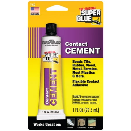

How did you stick the cover to the hull?
Spray adhesive under the majority of the leather on the main part of the saddle. Then I used contact cement (similar to photo) along the edge, held in place with binder clips until the glue dried.
