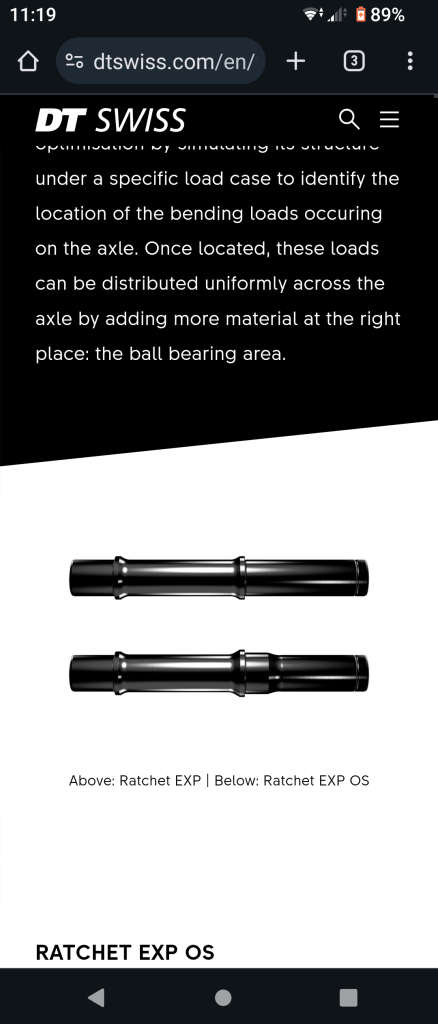

If the axle is oversized as the name suggests it doesn't seem to be externally, as the standard EXP freehub fits it. And it has to be 12mm internal so..
Posted : 30/11/2023 12:13 pm
Posts: 3293
The axle appears to be oversized within the body only which makes sense. So I suspect the freehub is standard EXP with the Hybrid ones being steel as stock.
