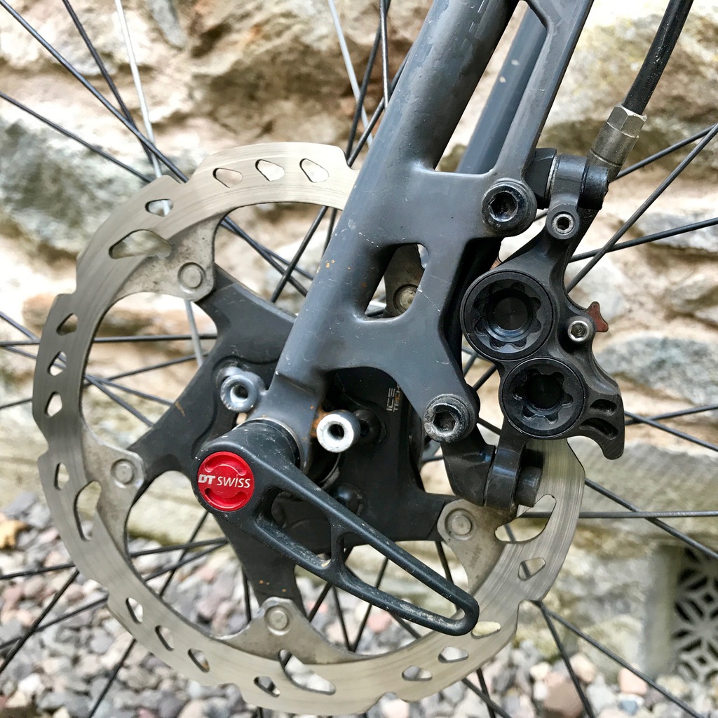

I've got one on the front of my Stoater (and one in a box which should be on the back but isn't, yet).
[img] ?dl=0[/img]
This was as easy to install as the Shimano ones, except I needed to shim the adapter out a bit to stop the calliper hitting it & getting out of alignment when tightened. I had to pump each of the four pistons out & push them back a few times - some seemed a bit sticky. When the pads were new I couldn't stop it dragging a bit. Now they'd bedded in & the pistons pushed back again it's fine.
This is at least as powerful as the Shimano ones. I don't think there's much more clearance if dragging / rubbing is a problem for you. This one is squealing a bit, but it's nothing like the honking from the Shimano ones with oil on the pads.

Help! I've just picked up some rx4 calipers and a hope 'A-post' IS to post mount brake caliper adaptor for the fork of my new croix de fer frameset but there isn't enough clearance between the big piston on the caliper and the adaptor itself for the bolt holes on the caliper to sit flush with the holes on the adaptor (almost a 5mm gap!).
What mount did you use for your stoater 'mrwalker'?
Has anyone else found an IS to post caliper adaptor that has the clearance for fitting this caliper to an IS mount fork?
Any help would be appreciated.
Failed to find one here so modified (I think) a 180 rear adaptor. Would have thought that it would be easy for Hope to make one but hey ho.

Posts: 77
i've got a set on my cx bike as hated cable
discs. they were a bit tricky to get the right adapters for and in the end used sram post mount stacks (thick spacers basically). bleed using reverb syringe as it has the right connection on nozzle.
performance wise they are mega, almost too
powerful but with loads of modulation. well worth the money spent in my view
