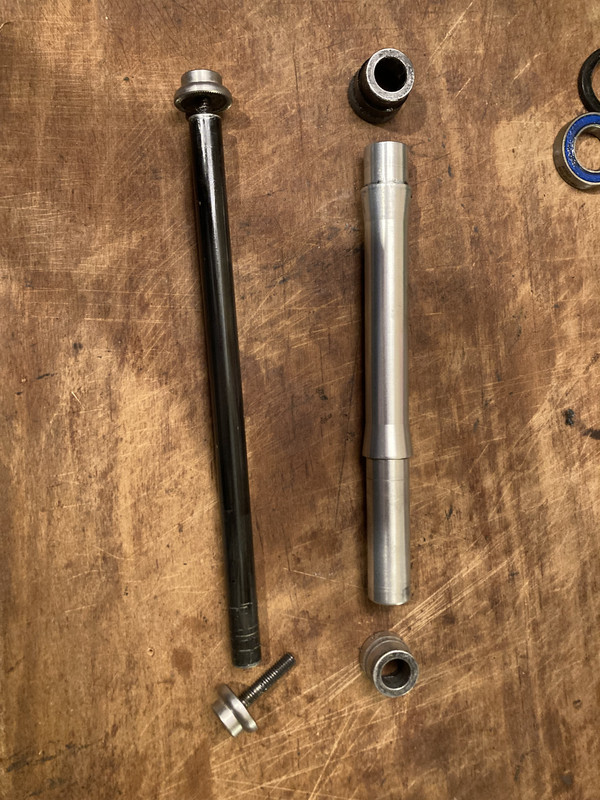

Aforementioned Mick offered that he could indeed likely machine me something much more up to the task. So off we went! I sent off an axle and bolt thru-axle from one of the hubs, along with a bunch of photos of the dropouts, and he took to machining a solid, stainless steel, with 'f-off' large 8mm bolts, axle that would likely be more up the task.
After delays on my side due to covid, and a fall on the hill whilst walking the dog requiring, embarrassingly, an MR rescue for a dislocated knee and lots of ripped muscles etc, I finally got round to fitting it in a hub and getting Nanny built back up again and ready for action. This would be in the full fat wheels, as the 29+ rear hub had shat it's ratchet ring and required the wheel stripped down and hub sent to Hope (with a long explanatory letter and after many phone calls - lets see if they develop an in house solution).
The new axle is a thing of absolute beauty. The old axle feels like it weights about 10g of heavily machined tinfoil, the new one feels like it's made out of the core of a neutron star. Reassuringly hefty 😎. Bearings slide on 'just so', the the old endcaps fit on perfectly, and the whole thing mounts in the dropouts right on the nose. Once I wind in the HUGE 8mm bolts, I'm ready for nuclear war! Clamping force at the dropouts is certainly no longer something I need more of, and flex should be banished.
I'm about 250km in on the full fat wheels, and it seems, with increasing optimism, that Mick has created the antidote to my misery. Thus far, none of the tell tale warning signals are present. I've had the free hub off a couple of times to check things seem rosy, and it is looking good. I will put a new free hub body in soon, as the tell-tale ratchet teeth marks on the body of the old one told of flex, and I want to see if that is banished.

My old axle and bolt thru on it's way to Mick
The new axle installed - 'quite' a solid set up and a 'quite' secure bolt at either side 🙂

Just found some pictures.
Aluminium with a 12mm hole down the middle and solid stainless with 20mm deep M12 holes each end. Wonder which bends more at the freehub shoulder under chain loading?....
[url= https://i.postimg.cc/x1CRd9qQ/axles.jp g" target="_blank">https://i.postimg.cc/x1CRd9qQ/axles.jp g"/> [/img][/url]
Choose your weapon. We went supersize.
[url= https://i.postimg.cc/0jkSHCwv/bolts.jp g" target="_blank">https://i.postimg.cc/0jkSHCwv/bolts.jp g"/> [/img][/url]

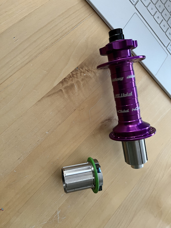

Thought I'd pop an update.
another couple of hundred kms done, and everything is still fine. I am confident now that things are indeed 'solid'. Checked the free hub last night, no scoring from the ratchet ring on the free hub body, inner bearing perfect, and pawls all in perfect nick.
We are golden!
On the other hub that I returned to Hope, after many phone calls explaining all of the above and that I really didn't expect them to warranty replace ANOTHER fatsno hub, and that could they please consider doing a solid steel axle... well, after they received my borked hub, I got no word at all from them except a couple fo days later when a brand new hub + spare free hub arrived.
So, as usual, amazing from Hope. However, kinda disappointed they haven't dealt with the source, even though they have replaced everything with no qualms.
Anyway, mick kindly making me a another solid steel axle now - cheers mick!
(new hub has already been laced to the 29+ rims, but I will wait to use it until I can put a 'proper' axle into it).
Posted : 04/02/2022 9:01 am
Posts: 13850
That hub looks like it has a bunch of Hope headset spacers glued into the middle, no surprise it was flexy 🙂
