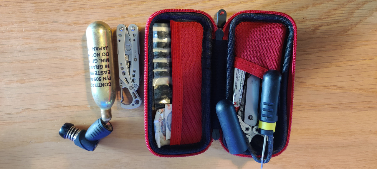

I bought the cheaper plastic version of that Lezyne tool and combined additional supplies in a soft case that doesn't rattle. Tool remains loaded for the least faff time.
tubeless stuff

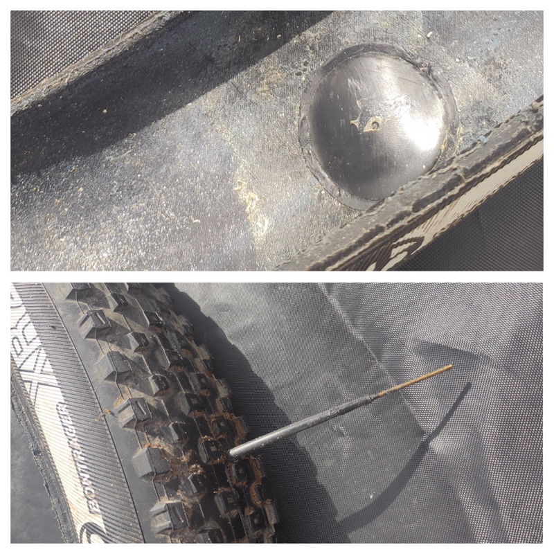

I've also seen mention in other, olderthreads of people using 'mushroom patches' to repair larger holes & cuts. Can anyone please explain how you use these? My initial thought was that the stem part of the mushroom is pushed through the damaged area from inside. But the adhesive would be on the wrong side of the patch to serve any purpose. Confused!

Mushroom patch - clean inside of tyre, apply vulcanising soln to patch and tyre and let go tacky as you would fixing a tube, pull patch through by the stalk, press to stick, let dry, cut off with a few mm still sticking out. You could apply more pressure by inflating a tube in the tyre but I never have.
Mushroom patch is a tidier finish and more secure in a tiny minority of punctures but generally not worth the bother if your trail fix is holding fine. Clearly you have to get inside the tyre to do it. I keep a few in stock in case of a puncture I think would be better fixed this way, like at the bead sometimes, although mushrooms still deform the tyre and require a bit to stick out, so a version of the same issue remains.

I’ve also seen mention in other, olderthreads of people using ‘mushroom patches’ to repair larger holes & cuts. Can anyone please explain how you use these? My initial thought was that the stem part of the mushroom is pushed through the damaged area from inside. But the adhesive would be on the wrong side of the patch to serve any purpose. Confused!
Yep, it goes through from the inside, and the adhesive goes between the patch and the tyre (and also on the bottom of the stem). It's a completely permanent fix (the air pressure holds it in place rather than wanting to blow it out, the glue is only sealing) and adds a bit of strength back to sidewalls which is useful where you've got a slice that wants to pull open. But it's 100% a "do it at home" job not a sensible trailside fix.
I reckon anchovies are close enough to permanent as to make not much difference most of the time- if it gets you home it'll probably last. But mushrooms are much tidier and give a bit more peace of mind so I'll usually pop one in when I get home. Once cut flush you can generally barely tell where they are.
